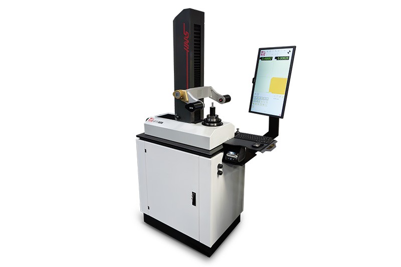

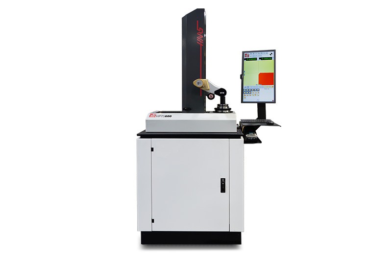

Haas Tool Presetter Series:
ORDER NOW - FREE SHIPPING!
Haas Tool Presetters, designed to streamline your workflow, are the ultimate solution for maximizing efficiency and maintaining precision in your machining operations. By eliminating the need for manual tool measuring, presetters allow tool offsets to be taken prior to each job, ultimately maximizing spindle time and leading to more efficient production runs.
Equipped with pre-installed training videos and step-by-step online guides, measuring and inspecting complex tool geometries becomes a breeze. At no extra cost, each presetter offers three versatile data transfer methods such as, LAN connection, USB, and data matrix scanner to transfer tool offset values, minimizing human error when inputting data. The built-in post processors support Haas Classic and Next Generation Controls (NGC), as well as numerous other machine control options.
Three presetter options are available, each tailored to meet specific customer needs. The range of X & Y axis travels, interchangeable taper sleeves to support numerous machines, and pneumatic capabilities for enhanced precision on the intermediate and advanced models, make these the most cost-effective and versatile solutions on the market.
Product Highlights:
  • Interchangeable Between 30, 40, 50, and HSK63A Taper Sleeves
  • Fine Micro Metric Adjustment
  • Runs on Singe-Phase Power (110V (1.8A) U.S. \ 230V (1.6A) EUR)
  • Dymo Thermal Printer
  • Windows Based Operating System With Simple and Intuitive Multi-Language Software
  • Post Processors for Haas Classic and Next Generation Controls (NGC)
  • Pre-Installed Presetter Training Videos for Ease of Use
HPTS600
  • Maximum X-Axis Travel: 15.748” (400 mm)
  • Maximum Z-Axis Travel: 23.622” (600 mm)
  • 20,000 Tool Memory
  • 200 Machine Origins
  • Pneumatic Axis Clamping
  • Pneumatic Tool Interlocking System
  • Pneumatic Taper Sleeve Brake
  • Standard 50 Taper Tool Sleeve
  • 24” Monitor
  • Stand-alone Unit
This Kit Contains:
  • 1x 09-0794: HPTS600 WITH 50-TAPER TOOL SLEEVE / DYMO LABEL MAKER
  • 1x 09-0012: INDUSTRIAL WIRELESS DATA MATRIX SCANNER
  • 1x 09-0014: LABELS (Pack of 2 rolls, #S0722400 DYMO® compatible labels)
*Please Note the DYMO label maker must only use the specified DYMO labels in the size 36mm x 89mm | 1-4/10” x 3-1/2” for the life of the printer.
Never make a mistake when manually typing in an offset value again . . . and don’t pay extra for the convenience.
The Haas HPTS600 is the most advanced model of the series, designed for precision and efficiency, this unit is equipped with an increased 20,000 tool and 200 machine origin memory, extended travel, and fully-loaded with a pneumatic clamping system. The HPTS600 now features an updated pneumatic X & Z axis clamping system that consistently and reliably locks both axes in place, enhancing the overall precision of the unit during measurement. Even when working with taller tools, the perfect balance of the support column allows for smooth movement all throughout the travel with minimal effort.
The Haas HPTS600 Tool Presetter comes complete with a high-precision 50-taper tool sleeve capable of holding CT50, BT50, SK50, DIN50, etc. Take full advantage of the precision ground spindle taper sleeve by utilizing the pull stud attachment along with the pneumatic system to create a wringing effect between the taper sleeve and the taper of the tool holder. When the tool holder is clamped down correctly, the wringing effect reduces errors related to parallax, misalignment, or positioning of surfaces ensuring that the measurement taken is as close to the true value as possible. The HPTS600 is now the first presetter in the series to feature a pneumatic spindle brake, which ceases any rotation around the Z-axis, completely fixing the tool in place when taking measurements. Optional interchangeable tool sleeves include 30, 40, and HSK63A tapers that can be purchased separately. Each tool sleeve has a reference notch for ease of calibration.
The HPTS600 connects to your local area network (LAN), and the built-in software includes post-processors for Classic and Next Generation Haas controls, as well as dozens of other control types. The Haas post-processors format the tool measurement data into files that can be transferred to the Haas machine over the network, or written to a USB memory device to load directly into a machine control.
However, the preferred method is to use the provided thermal printer and the Haas industrial data matrix scanner. The HPTS600 package includes everything you need to print a label for each tool, with offset data imbedded in a data matrix code, similar to a QR code.
The HPTS600 software formats the measured tool data and other tool information into a data matrix code. The connected thermal printer then prints a label for each tool. Use the Tool File Wizard or the Tool Scan Wizard feature on Haas NGC controls (software version 100.20.000.1200 or later) and the included wireless industrial data matrix scanner to scan the tool data from each label, and update the tool offsets in the control as each tool is being loaded into the Haas machine.
The Haas Wireless Industrial Data Matrix Scanner uses 2.4GHz wireless operation utilizing a USB receiver. It also comes with a USB cable for wired connection to the Haas control, and for recharging the built-in 2000mAh battery.
The included thermal printer prints the tool data to the provided labels as a data matrix code, with the information embedded. Direct thermal printing eliminates the need for costly ink or toner, and provides professional quality prints at 300 x 600 dpi. Printing is fast and efficient, and utilizes standard DYMO brand labels.
The Haas HPTS600 is a fully equipped, sturdy, and easy-to-use tool presetter at an amazing price. With its user-friendly Windows-based operating system, measuring tool geometry and getting the values into your Haas CNC are easy and intuitive.
  • 12-month parts warranty from ship date, supported by your local Haas Factory Outlet; on-site installation, training, service labor, and travel charges will apply

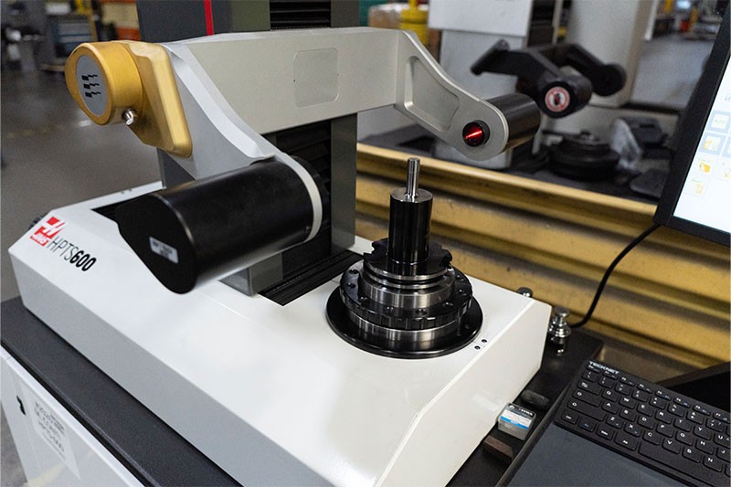

The HPTS600 is a complete tool presetting solution that includes everything you need to start dramatically reducing your setup times – right out of the box. The Haas Tool Presetter moves the tool measurement function out of your machine – so it can continue making chips (and money) – and into the shop, where the hourly rate is lower.
The Haas HPTS600 Presetter Includes:
  • 50-Taper Tool Sleeve
  • Industrial Wireless Data Matrix Scanner
  • Thermal Printer
  • Labels
Optional Tool Sleeves Available:
  • 30-Taper
  • HSK63A
Reduce Setup Errors
Does your shop have a tool presetter? One that prints labels with tool offset data for each tool?
That’s great! Now go watch your operators. Are they literally typing the offsets into the machine from the labels?
Stop relying on fat-finger data entry! There is a MUCH better way.
With the HPTS600, you have three options to get the tool offset data into your Haas control quickly and easily.
Tool Data Transfer Methods:
  • Over wired LAN connection – Good
  • Via portable USB memory device – Better
  • Via wireless data matrix scanner – Best
*Please Note the DYMO label maker must only use the specified DYMO labels for the life of the printer.
Seamlessly Transfer Offset Data
Once a tool or group of tools is measured, you have several options to get the data into the Haas control.
Haas Next Generation Controls (NGC) with the latest software include support for the HPTS600 with a Tool Scan Wizard and Tool File Wizard. At the HPTS600, use the supplied Thermal Printer to print offset data labels for each measured tool. At the Haas machine, use the supplied Industrial Wireless Data Matrix Scanner to read the offset data from the printed labels into the control. The Tool Scan Wizard guides you through scanning the label, loading the tool into the spindle, and then executing a tool change to the next tool to load the data.
The HPTS600 has post-processors for Classic and Next Generation (NGC) Haas Controls. These post processors format the tool offset data and save it to files that can be copied to a USB memory device at the HPTS600, and that USB device can be delivered to the machine with the measured tools. For the Classic controls, this is the best option for loading the offset data. The same method also works for NGC controls.
Another option is to connect the HPTS600 to your local network and transfer the offset data files directly to the machine control and then load the offsets. Loading these offset data files only appends the offset data of the offset numbers measured on the HPTS600. Tool offset data for tools not measured remains unchanged.
Tool Presetter Support in NGC Controls
Press [ALTER] from the Tool Offsets page to launch the wizards.
The Tool Scan Wizard allows you to scan tool measurement data for individual tools from printed labels, and either merge the data on the label with data already in that particular offset, or reset all data for that offset and then load the scanned data.
The Tool File Wizard also gives you the choice to merge data, or reset the data and then load all the offset data. The wizard then cycles through and gives the option to perform a tool change to each tool with imported data.
Be sure to check out the Haas Tool Presetter How-To Videos for much more information on using the unit and these features.
