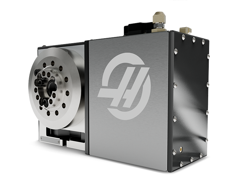

Quick Drawbar Rotary with A1-5 Spindle Nose
  • 1 Spindles
  • A1-5 Platter Size
  • 150 ft-lb Max Torque
  • 130 °/sec Max Speed
Compare Machines
EXPLORE ALL INVENTORY
The HQDA5 is a single-axis rotary table with an A1-5 spindle nose and a pneumatic “quick drawbar” system for activating a variety of workholding options, including 3-jaw chucks, as well as 5C, 16C, and 3J collet chucks. The rotary comes standard with a manual air clamping provision that allows clamping/unclamping via toggle valve.
Note: Requires a Haas mill with 4th-axis drive and NGC software version 100.21.000.1130 or later for full 4th-axis operation. Stand-alone operation requires a Haas rotary control box shipped after November 10, 2021, with software version 26.38 or newer.
  • A1-5 spindle nose
  • Manual air clamping provision w/toggle valve
  • Accepts 3-jaw power chucks, 5C, 16C, and 3J collet chucks
  • Easy plug-and-play connection to Haas machines
  • Industry-leading performance and capabilities

Platter S.A.E METRIC
Max Weight on Platter (w/support) 90 lb 40.8 kg
Max Weight on Platter (unsupported) 45 lb 20.4 kg
Spindle S.A.E METRIC
Max Speed 130 °/sec 130 °/sec
Torque (Continuous) 150 ft-lbf 203 Nm
Runout Max 0.0005 in 0.013 mm
Center Height 5.000 in 127.00 mm
Backlash 30 arc-sec 30 arc-sec
Brake Torque @ 100 psi/6.9 bar 100 ft-lbf 136 Nm
Gear Ratio 63:1 63:1
Timing 2:1  2:1
Tooling A1-5 Spindle A1-5 Spindle
Worm Gear Dia 4.7 in 119 mm
Indexing S.A.E METRIC
Accuracy (±) ± 15 arc-sec ± 15 arc-sec
Repeatability 10 arc-sec 10 arc-sec
Resolution 0.001 ° 0.001 °
Max Rotation/Step (with rotary control) 999.999 ° 999.999 °
General S.A.E METRIC
Power Requirement 115 VAC ±10% @ 15 A 115 VAC ±10% @ 15 A
Operating Temp (max ambient) 100 °F 38 °C
Air Requirements S.A.E METRIC
Air Pressure Max 150 psi 10.3 bar
