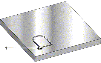

These example programs show how different scaling centers affect the scaling command.
G51 No Scaling Gothic Window: [1] Work coordinate origin.
O60511 (G51 SCALING SUBPROGRAM) ;
(G54 X0 Y0 is at the bottom left of window) ;
(Z0 is on top of the part) ;
(Run with a main program) ;
(BEGIN CUTTING BLOCKS) ;
G01 X2. ;
Y2. ;
G03 X1. R0.5 ;
G01 Y1. ;
M99 ;
The first example illustrates how the control uses the current work coordinate location as a scaling center. Here, it is X0Y0Z0.
