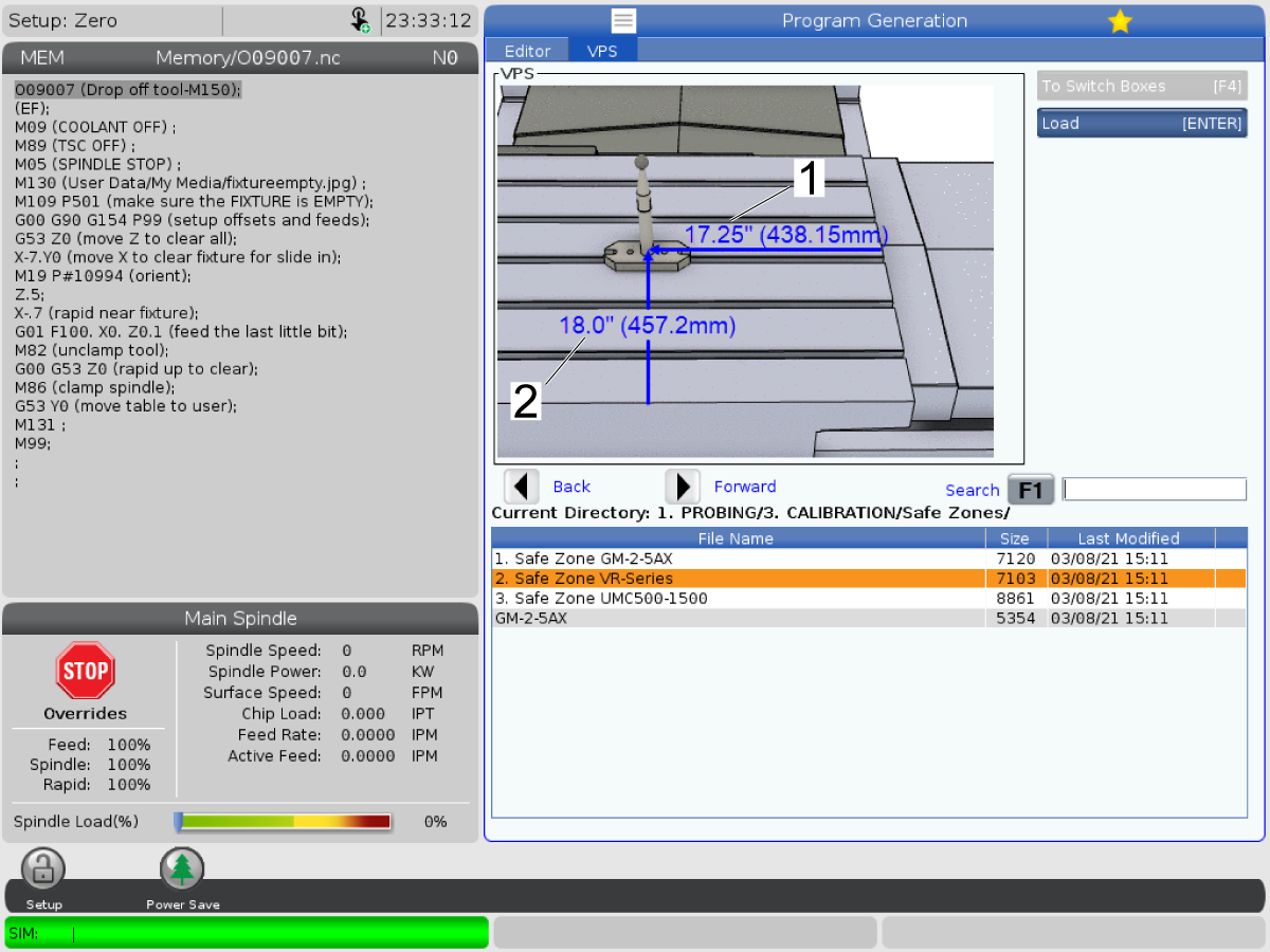

Place the straight sphere assembly in the center T slot and 17.25" [1] from the right edge of the table and 18.0" [2] from the bottom of the table. This will be done for both the MRZP and safe zones.

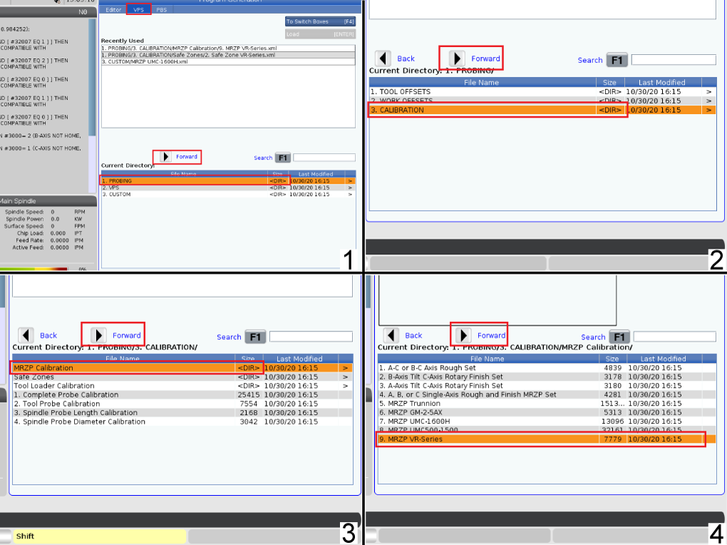

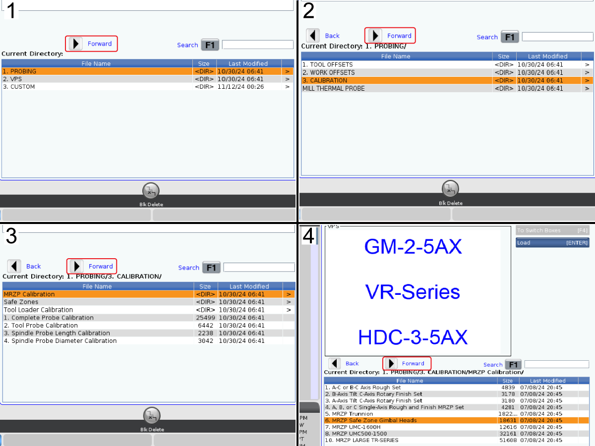

Press [EDIT] and go to the VPS tab. Once there using the direction buttons highlight  the probing directory and press [RIGHT ARROW].
Once there highlight CALIBRATION and press [RIGHT ARROW].
Highlight MRZP CALIBRATION  and press [RIGHT ARROW].
Highlight MRZP SAFE ZONE GIMBAL HEADS and press [RIGHT ARROW].

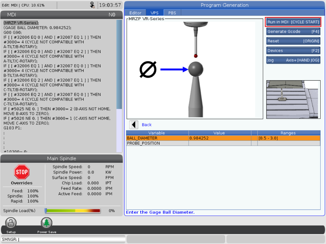

Input the ball diameter measurement and follow the probe position description at the bottom of the window.
 NOTE: With B and C-Axis at 0, the probe should be 0.25" above the sphere.
Press [F4] to populate the program to MDI and go over the program, before pressing  [CYCLE START].
or
Press [CYCLE START] to run the MRZP and Safe Zone program in MDI immediately .

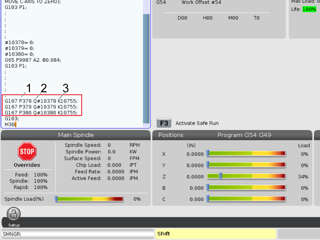

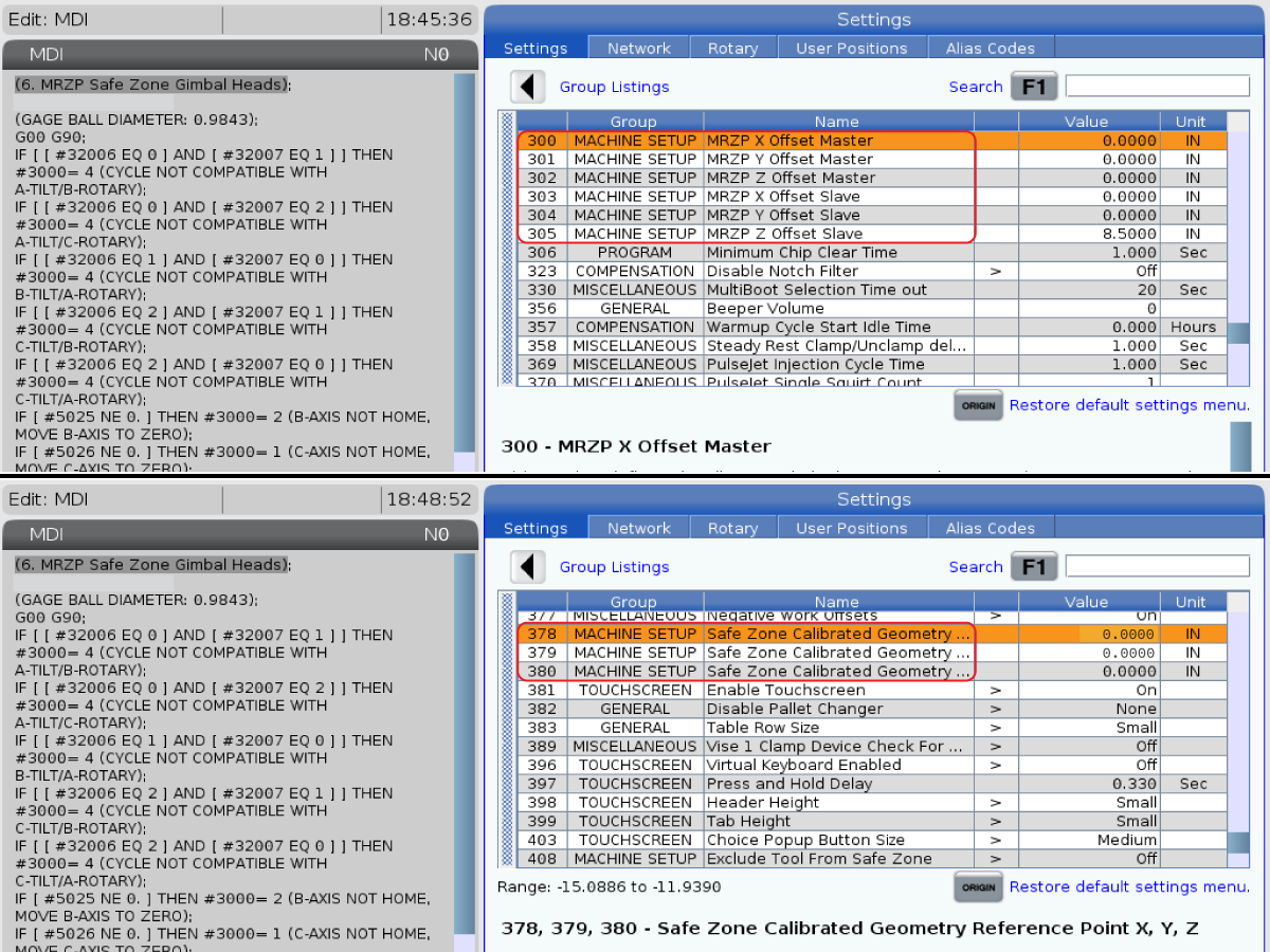

The MRZP and Safe Zone program will populate the values that are found into the settings page using the code shown in the picture.
G167 provides the ability to write to settings, P code [1] is the setting number the program is writing to, Q code [2] is the value of the Macro Variable the P code setting will be populated with, and the K code [3] essentially means it will keep these values in the setting once the program is over.
Verify MRZP settings 300-305 and 378-380 are populated.
7

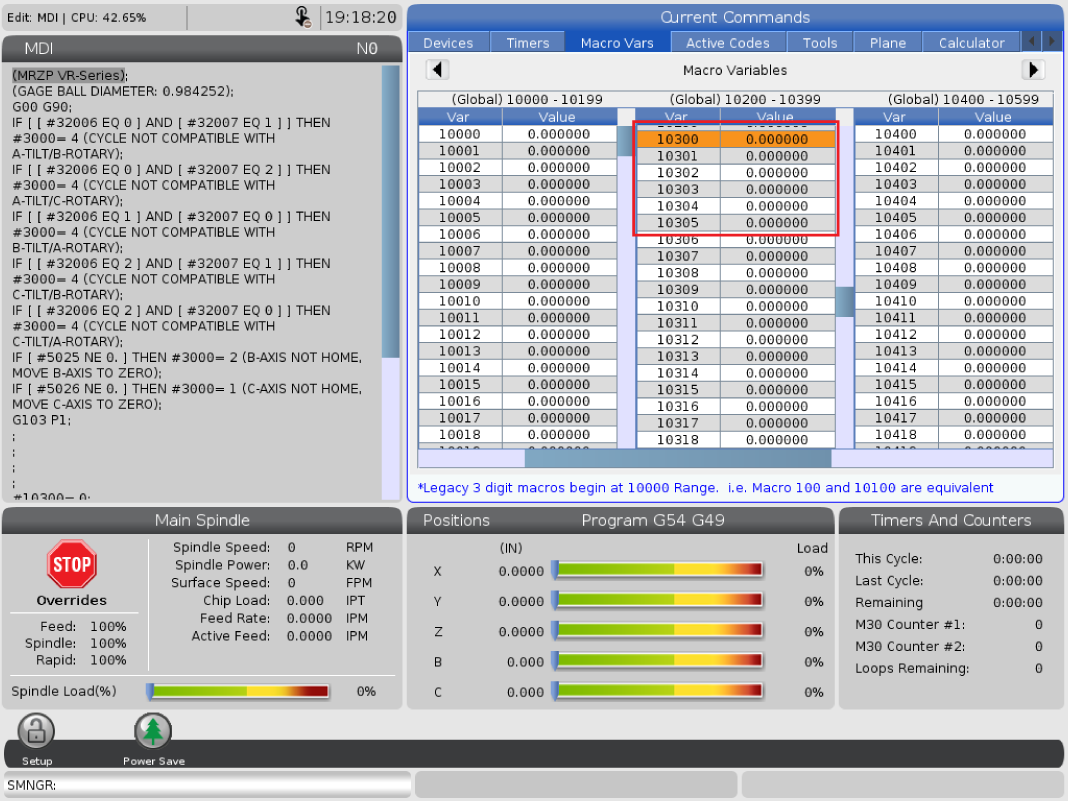

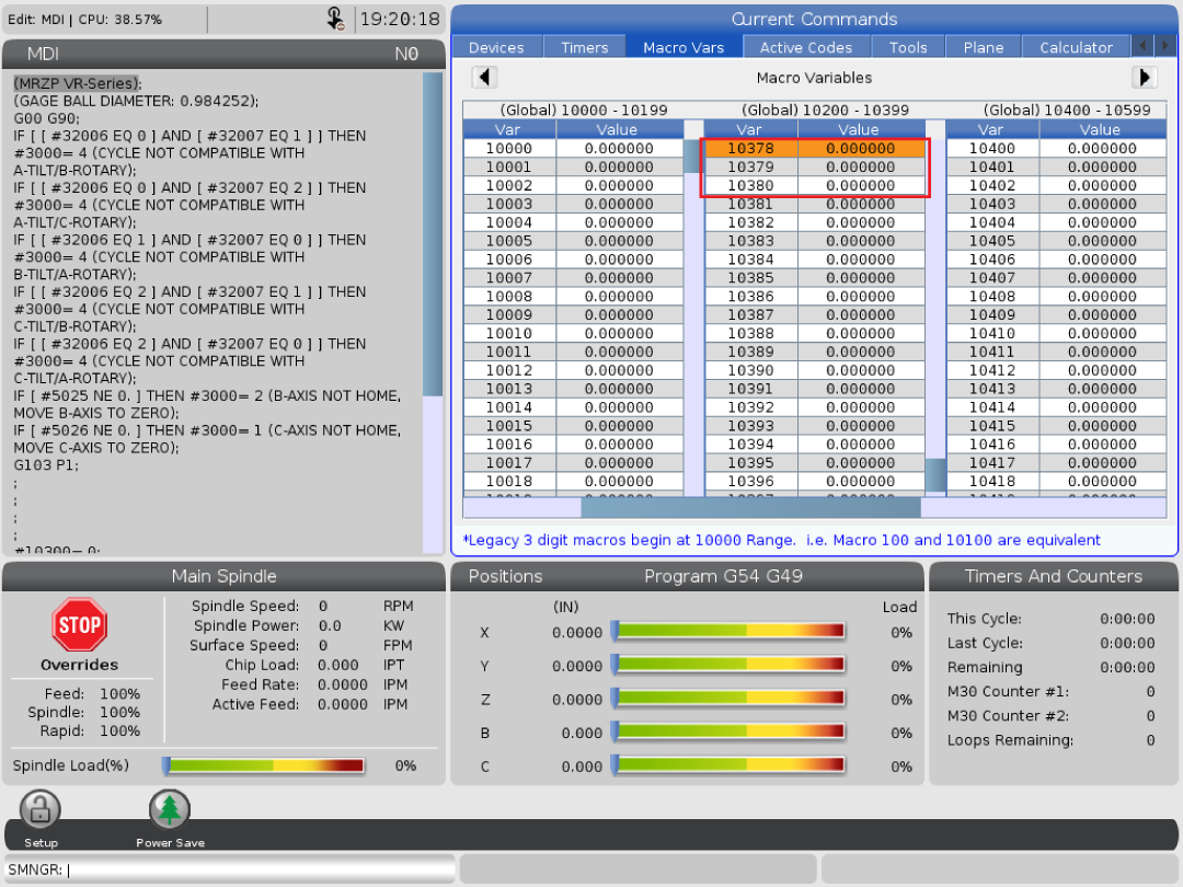

Once the MRZP program finishes press [CURRENT COMMAND] and go to the Macro Variable tab and find variables 10300-10305 and 10378-10380, write these values on a piece of paper.
8
Press [SETTING] and look for settings 300-305 and 378-380. Verify the values written on the piece of paper match the setting values. They should correspond as follows: Macro Variable 10300 = Setting 300 and so on.

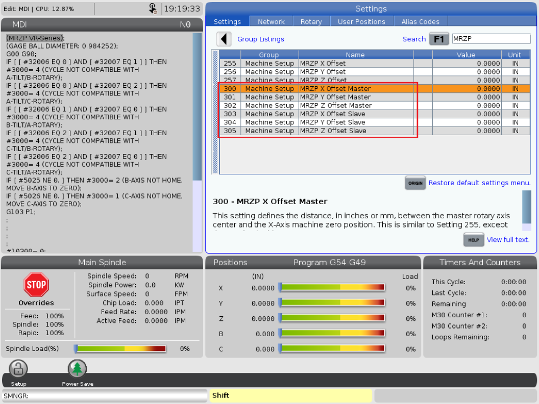

The MRZP program will populate the values that are found into the settings page using the code shown in the picture.
Verify settings 300-305 are populated.
7
Once the MRZP program finishes press [CURRENT COMMAND] and go to the Macro Variable tab and find variables 10300-10305, write these values on a piece of paper.
8
Press [SETTING] and look for settings 300-305, input the values written on the piece of paper. They should correspond as follows: Macro Variable 10300 = Setting 300 and so on.

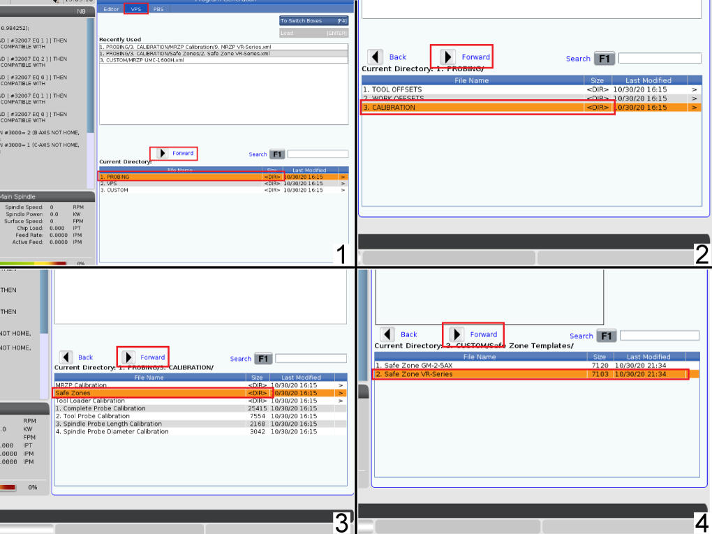

Highlight SAFE ZONES and press [RIGHT ARROW].
Highlight SAFE ZONE VR-SERIES and press [RIGHT ARROW].

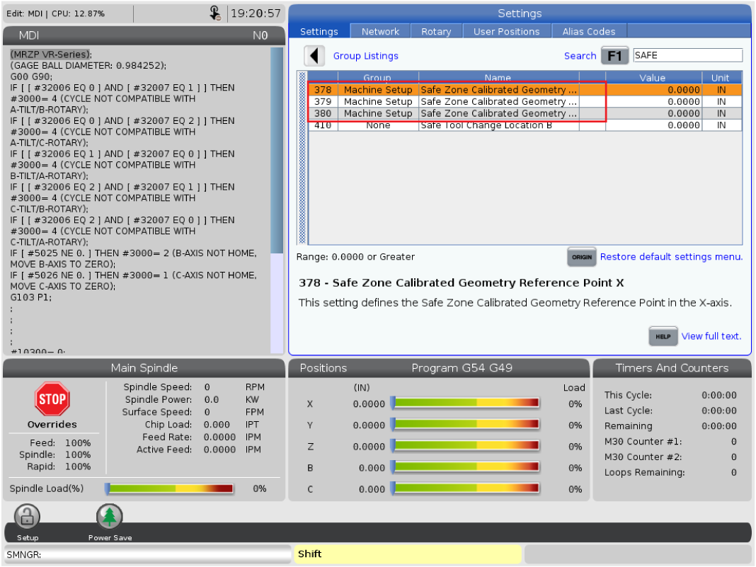

The Safe Zone program will populate the values that are found into the settings page using the code shown in the picture.
Verify settings 378-380 are populated.
7
Once the Safe Zone program finishes press [CURRENT COMMAND] and go to the Macro Variable tab and find variables 10378-10380, write these values on a piece of paper.
8
Press [SETTING] and look for settings 378-380, input the values written on the piece of paper. They should correspond as follows: Macro Variable 10378 = Setting 378 and so on.
