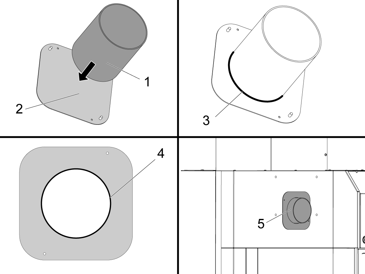

Remove the top sheet metal cover [3] from the right side enclosure wall to gain access to the mist extractor cover [1] mounting hardware.
Remove the inner and outer mist extractor cover [1].
Weld [3] appropriate size tubing [1] to the back of the mist extractor cover [2].
 Note: The diameter of the tubing will depend on the size of the mist extractor duct and need to be at least 7" (180mm) long.
Cut out the opening [4] in the mist extractor cover, that is smaller than the inner diameter of the tubing.
Cut out the opening on the second mist extractor cover, that is larger than outer diameter of tubing.
Install the modified covers back onto the enclosure.
 Note: The cover with the tube is to be installed on the inner enclosure panel.
Attach the mist extractor duct to the tubing [5].
