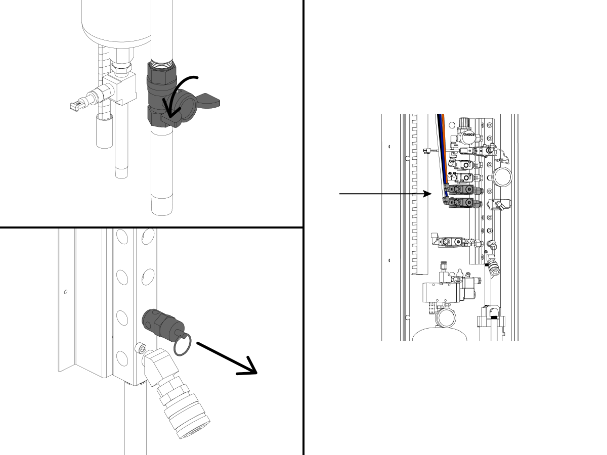

  • Press the Emergency Stop
  • Open the Lube/Air panel door.
  • Rotate the ball valve as shown to cut off air the machine.
  • Pull the ring on the Pressure relieve valve to release remain pressure in the system.
Note: The wings of the valve should be perpendicular to the pipe.

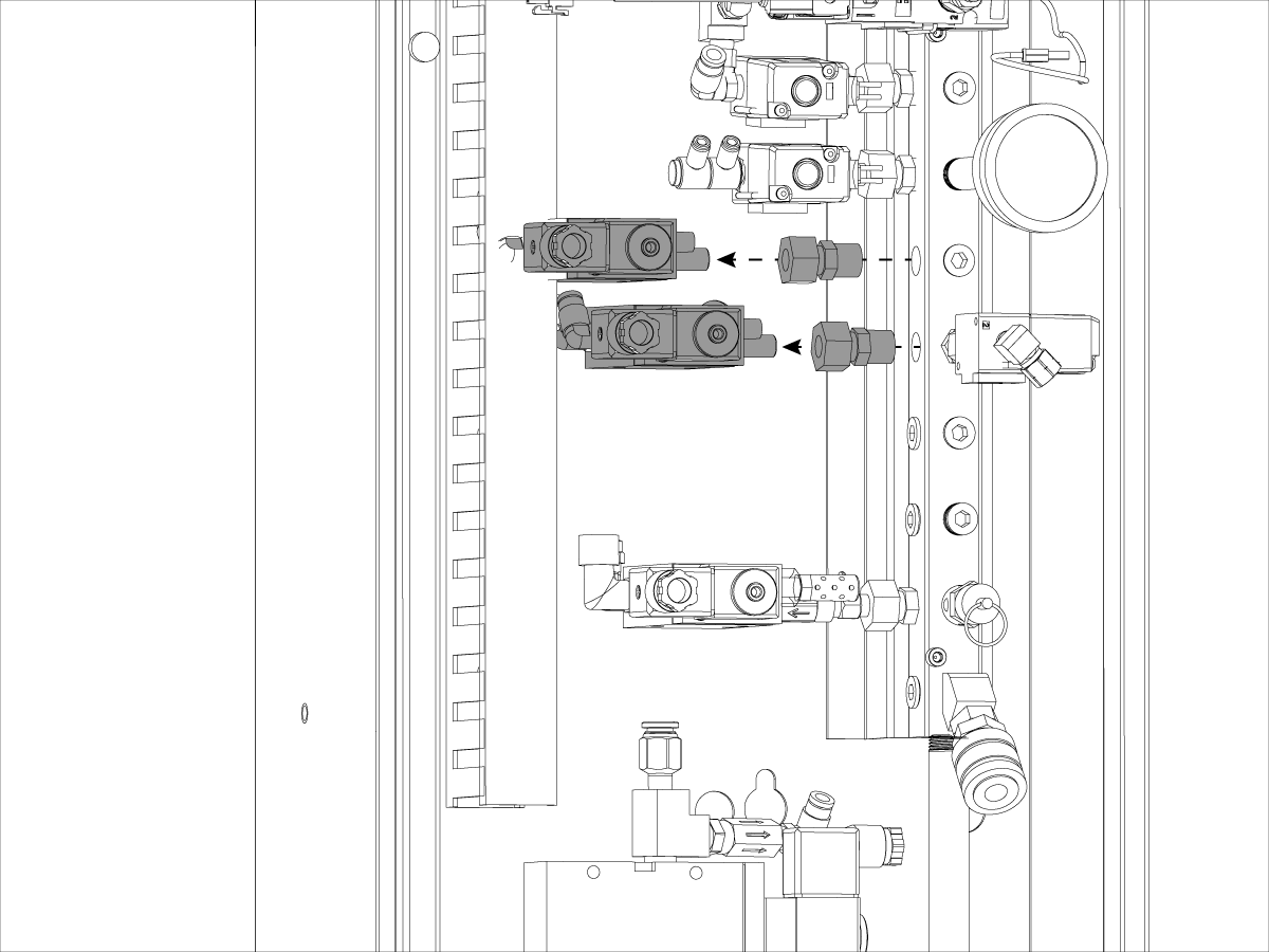

  • Locate the 4th and 5th axis solenoids on the supply manifold.
  • Remove both solenoid and hardware from the supply manifold.
Installation
  • Install a NPT1/4M PLUG STL (provided in kit) into the port for the 4th axis solenoid.
  • Install the Brake Air Regulator into the supply manifold.
  • Using the original fittings connect the 4th and 5th axis Brake Solenoids to the Brake Air Regulator.
