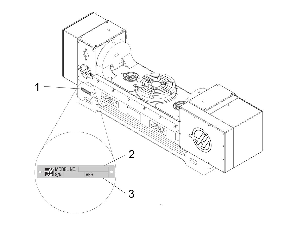

Locate the name plate [1] to identify the rotary.
NOTE: Different rotary machines will have different name plate locations.
Make note of the rotary model number [2] and the version [3].
With this information, enable the rotary parameters on the Next Generation Control to connect the rotary with the machine. Refer to Enable Rotary Axis for more information.
