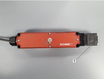

EUCHNER Interlocks:
Instead of replacing the complete interlock assembly, you can replace the interlock head [1] with PN#93-2309.  Refer to Door Interlock - Euchner - Head - Replacement.

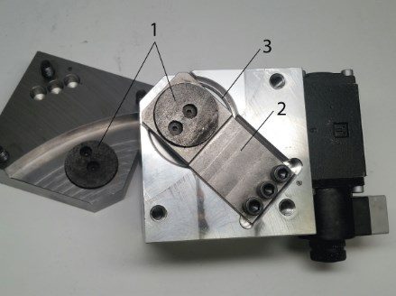

Lathe Brake Assemblies:
30-0137A LT Brake Assembly, $695.00. The lathe spindle brake assembly is a heavy chunk of steel that can be costly to ship. In most cases the housing and solenoid are not the issue. The typical faults are with worn pads, 57-0045 $35.00 ea [1] or a broken finger, 20-0199A $75.00 [2]. The only reason to replace the complete assembly would be if the piston bore was damaged and it was leaking oil [3]. If leaking, the bore should be inspected for damage to see if the assembly needs to be replaced or if the problem is just an O-Ring.
