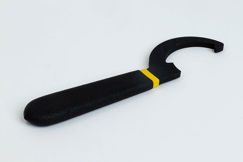

Note: Haas NC Keyless Drill Chucks requires use of spanner wrench (06-0385) in order to properly tighten chucks. Spanner wrench sold separately.

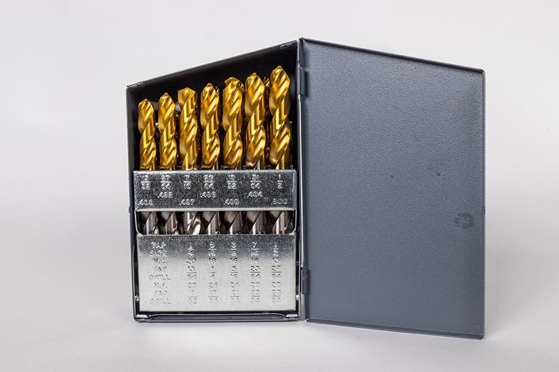

29-Piece, 1/16" - 1/2" Cobalt Jobber Drill Set, Fractional
Part #: 03-0255
RETAIL PRICE:
116.97
26-Piece, A - Z Cobalt Jobber Drill Set, Letter
Part #: 03-0256
RETAIL PRICE:
107.97
56-Piece, #1 - #56 Cobalt Jobber Drill Set, Number
Part #: 03-0257
RETAIL PRICE:
84.97
NPU13 Keyless Drill Chuck Spanner Wrench
Part #: 06-0385
RETAIL PRICE:
4.97
