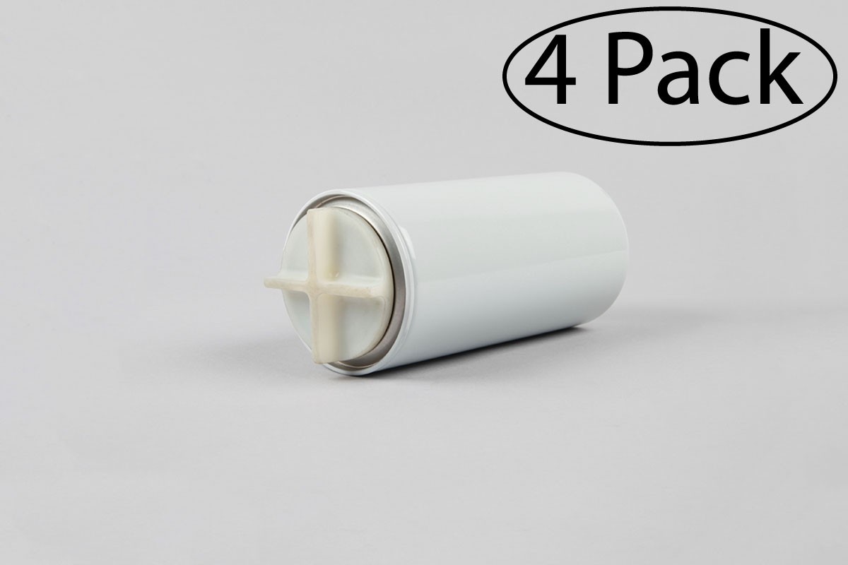

HAAS LIQUID GREASE, 4 PACK REFILL – CAN 33 FL OZ / 1L - Pack of 4
Part #: 93-2627A
HAAS LIQUID GREASE REFILL 4 PACK
ATTENTION! Haas Liquid Grease (HLG) cartridges and refills are no longer available.
To increase system performance and reliability, Haas has converted the machine axis lubrication system from grease to oil. Machines using HLG should be converted to Haas Axis Lubrication Oil, at the earliest convenience. See details above.
