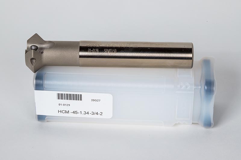

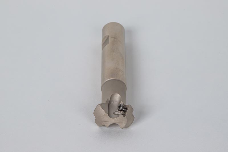

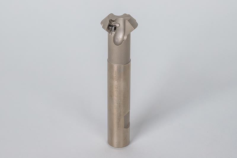

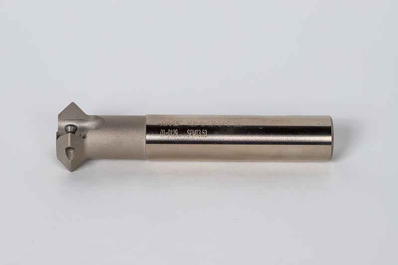

45° Indexable Chamfer Mill, 0.750" - 1.319" Diameter x 3/4" Shank x 4.724" Overall Length, 2 Inserts
Part #: 01-0129
HCM-45-1.34-3/4-2 45 DEG CHAMFER MILL
Price: 125.95 ( / unit)
88.97
This 45-degree indexable chamfer mill has a 0.75 in \ 3/4" minimum cutting diameter and a maximum cutting diameter of 1.319". It has a 3/4" shank diameter and an overall length of 4.724". It takes 2 square chamfer inserts (SPㅁㅁ1104ㅁㅁ), which are available in grades for steel, stainless steel, cast iron, aluminum/non-ferrous materials, and hardened metals.
Tool Or Insert Tool
[ØDC] Cutting Diameter 0.75 in
[ØDCX] Max Cutting Diameter 1.319 in
[ØDMM] Shank Diameter 0.75 in
[OAL] Overall Length 4.724 in
[LH] Head Length 1.574 in
[Ap] Max. Cutting Depth 0.275 in
[SIG°] Chamfer Angle 45 Degree
[NOF] Number of Flutes 2
Insert Size SPㅁㅁ1104ㅁㅁ
Weight 0.6 lbs \ 0.3 kg
