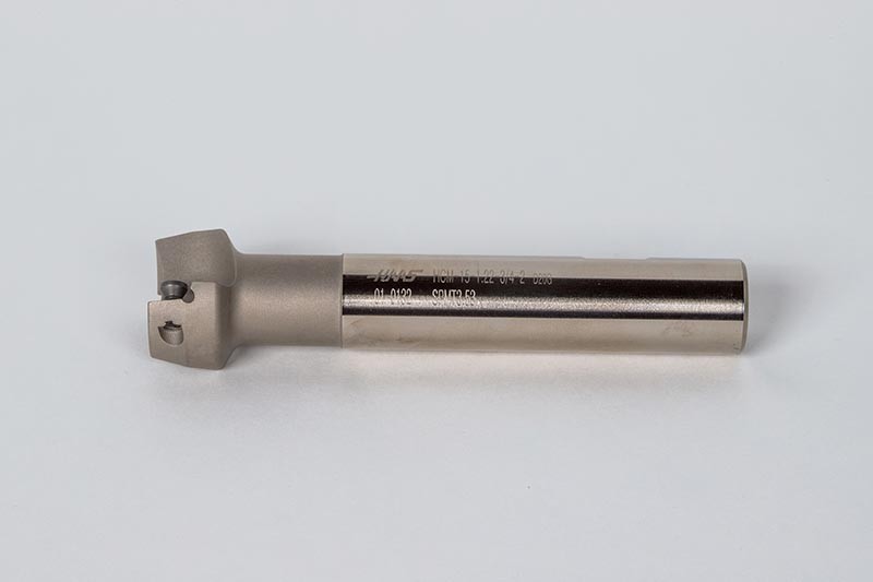

15° Indexable Chamfer Mill, 1" - 1.204" Diameter x 3/4" Shank x 4.724" Overall Length, 2 Inserts
Part #: 01-0132
HCM-15-1.22-3/4-2 15 DEG CHAMFER MILL
Price: 115.95 ( / unit)
86.97
This 15-degree indexable chamfer mill has a 1.0 in \ 1" minimum cutting diameter and a maximum cutting diameter of 1.204". It has a 3/4" shank diameter and an overall length of 4.724". It takes 2 square chamfer inserts (SPㅁㅁ1104ㅁㅁ), which are available in grades for steel, stainless steel, cast iron, aluminum/non-ferrous materials, and hardened metals.

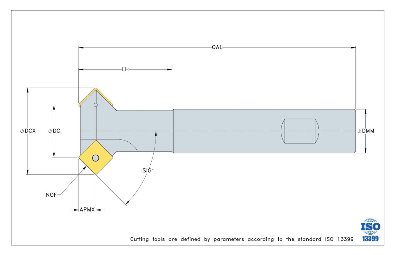

Tool Or Insert Tool
[ØDC] Cutting Diameter 1.0 in
[ØDCX] Max Cutting Diameter 1.204 in
[ØDMM] Shank Diameter 0.75 in
[OAL] Overall Length 4.724 in
[LH] Head Length 1.574 in
[Ap] Max. Cutting Depth 0.376 in
[SIG°] Chamfer Angle 15 Degree
[NOF] Number of Flutes 2
Insert Size SPㅁㅁ1104ㅁㅁ
Weight 0.6 lbs \ 0.3 kg
