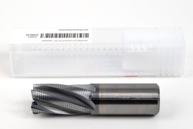

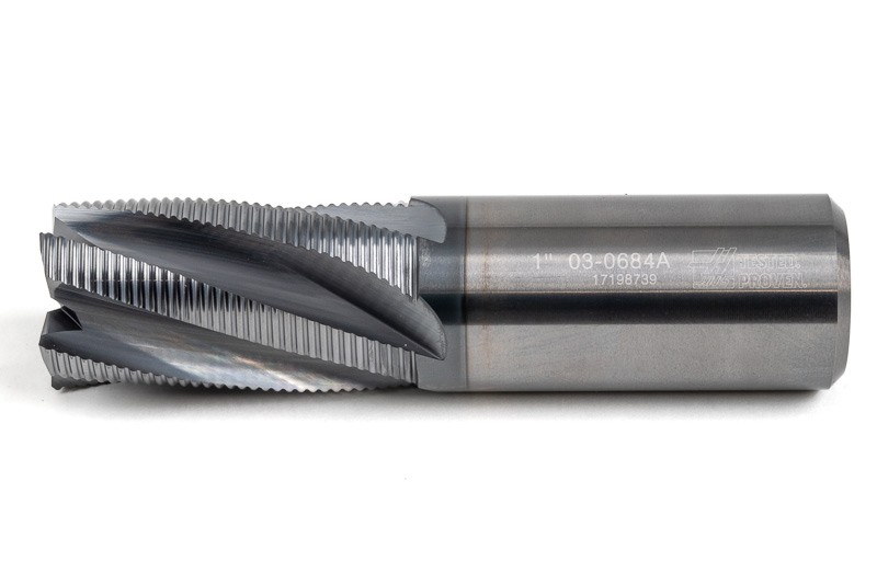

1" Dia. Carbide Fine Roughing End Mill, 5 Flute, Hybrid AlCrN Coated, 1" Weldon Shank x 1-3/4" LOC, 0.024" Chamfer, FPCLH
Part #: 03-0684A
REM 1" LOW HELIX 5 FL CARB ALCRN WF
Price: 216.95 ( / unit)
195.97

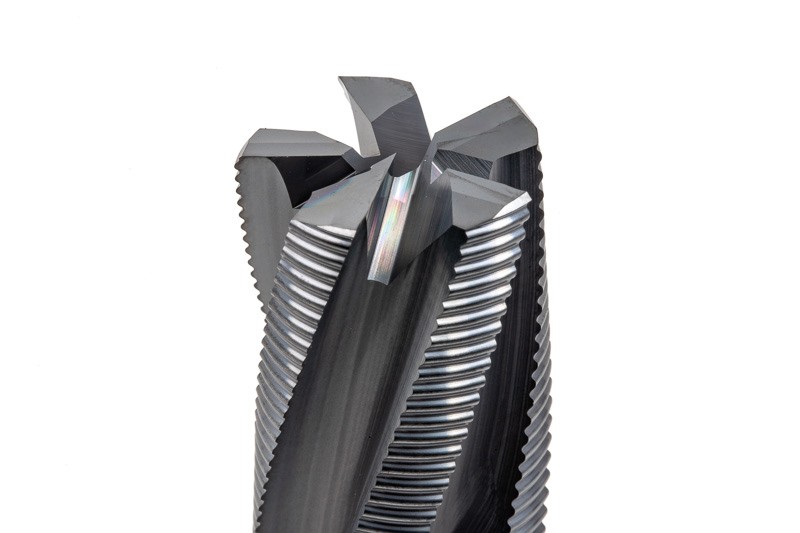

This FPCLH 5-flute carbide roughing end mill has a 1.0 in \ 1" cutting diameter, with a 1" weldon shank, 1-3/4" length of cut (LOC), 0.024" chamfer, and a 4" overall length. It is hybrid AlCrN coated, and made to cut steel and hardened metals. This roughing end mill is designed to center-cut.
ISO Material Chart
Haas Milling Series FPCLH
Primary Workpiece Material H - Hardened Steels, P - Steel
Material Carbide
Coating Hybrid AlCrN
Corner Type Chamfer
Shank Type Weldon
[ØDC] Cutting Diameter 1.0 in \ 1"
[ØDMM] Shank Diameter 1.0 in
[LOC] Length Of Cut 1.75 in
[OAL] Overall Length 4.0 in
[NOF] Number of Flutes 5
[CHW\RE] Chamfer \ Radius Size 0.024 in
[FHA°] Helix Angle 20
Cutting Direction Right
Center Cutting Yes
Variable Pitch No
Through Spindle Coolant No
Weight 1.4 lbs \ 0.6 kg
