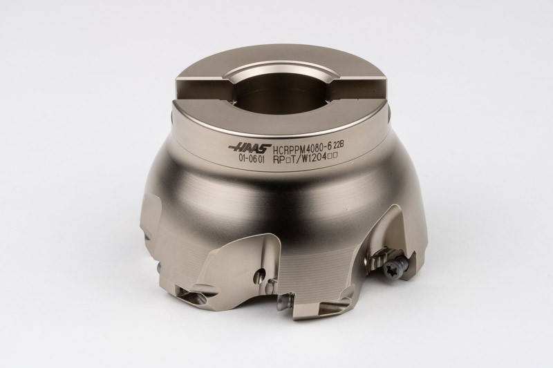

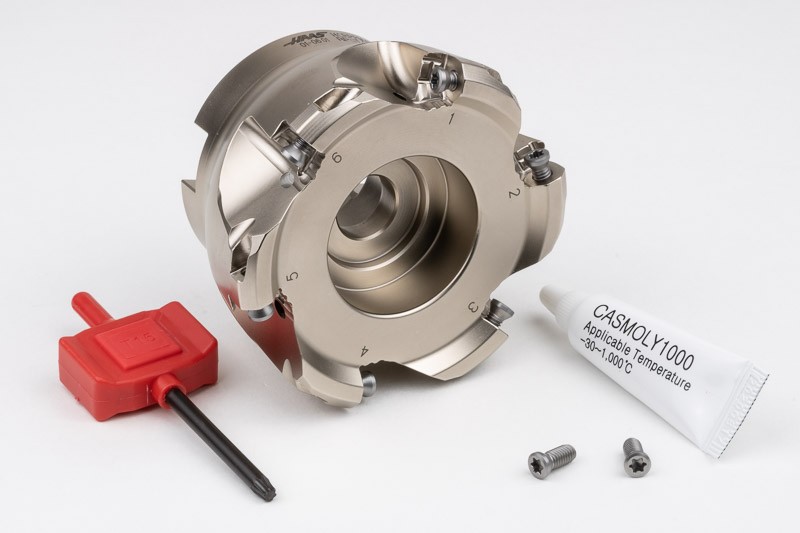

This Haas Round Positive Positive (HRPP) medium-pitch shell mill is a button-style cutter that excels in most roughing applications, for a wide range of materials. The uneven flute spacing and unique design of the insert seat help minimize insert movement and excessive vibration, which promote even greater stability while heavy machining. This allows the cutter to excel across various toolpath types, including copy milling, face milling, helical milling, ramping, shoulder milling, and slotting. It has a 80mm cutting diameter, and a 27mm pilot bore, with a radial cutting edge. The positive axial, positive radial-raked cutter body takes 6 round cutting inserts. The screw-clamp inserts have 4-8 cutting edges, and are available in grades for steel, stainless steel, cast iron, and aluminum/non-ferrous materials. This cutter body is through-tool coolant (TSC) capable, when used in conjunction with a coolant-through arbor screw. Inserts and coolant-through arbor screw sold separately.
  • Technical Documents
[ØDC] Cutting Diameter 80.0 mm
Milling Cutter Series HRPP - Haas Round + / +
Toolpath Type Ramping, Face Milling, Copy Milling, Slotting, Shoulder Milling, Helical Milling
[ØDCN] Min. Cutting Diameter 68.0 mm
[ØDCX] Max Cutting Diameter 80.0 mm
[°] Lead Angle 11 Degree
[Z] Number of Cutting Teeth 6
[Ød1] Diameter 14.0 mm
[Ød2] Diameter 25.0 mm
[Ød] Arbor Hole Diameter 27.0 mm
[E] Arbor Hole Depth 23.0 mm
[a] Keyway Width 12.4 mm
[b] Keyway Depth 6.3 mm
[Ap] Max. Cutting Depth 6.0 mm
[OAL] Overall Length 50.0 mm
Maximum RPM 7000
Torque of Insert Screw 300 Ncm
Coupling Style A
Through Tool Coolant Yes
Weight 2.0 lbs \ 0.9 kg
