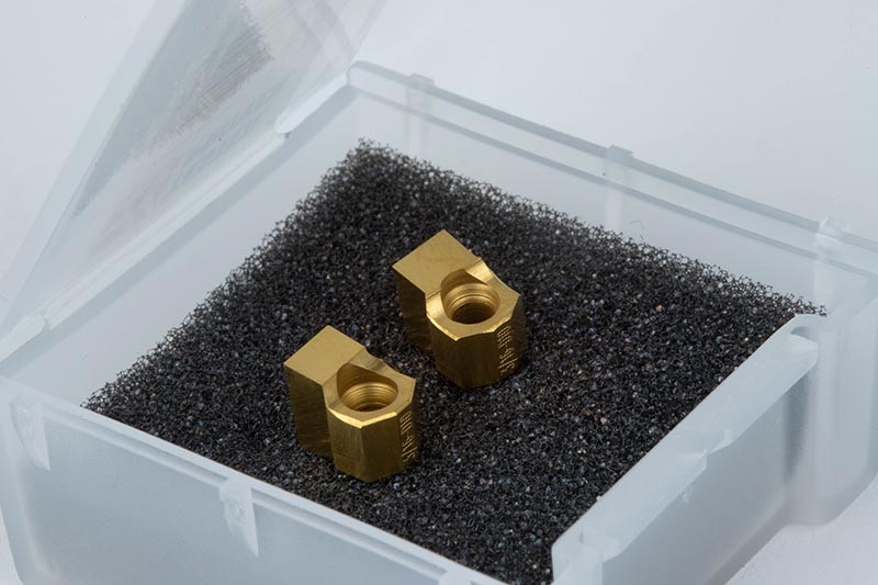

HIN, 3/16” Keyway Broaching Insert, D10 Clearance Fit, Size 5, TiN Coated - Pack of 2
Part #: 02-0846
HIN-3/16" D10

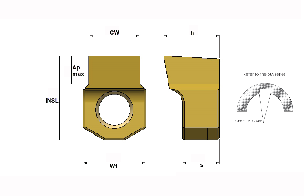

Insert Style Keyway
Insert Size 5
Broach Width 0.1875 in \ 3/16"
Fit Tolerance D10 - Clearance Fit
Primary Workpiece Material P - Steel, N - Aluminum, K - Cast Iron
Secondary Workpiece Material S - High Temp Alloys, M - Stainless Steel, H - Hardened Materials
Chamfer No
[CW] Cutting Width 0.1905 in
[INSL] Insert Length 0.315 in
[W1] Insert Width 0.239 in
[h] Insert Height 0.276 in
[Ap] Max. Cutting Depth 0.13 in
[S] Insert Thickness 0.197 in

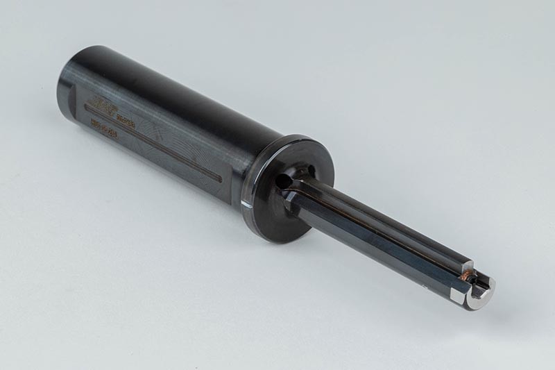

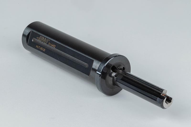

HUT-05-25, 13mm Ø Internal/External (ID/OD) Keyway Broaching Tool, 25mm Shank x 46mm Cut Depth, Neutral, Insert Size 5
Part #: 01-0482

HUT-05-25-L, 13mm Ø Internal/External (ID/OD) Keyway Broaching Tool, 25mm Shank x 66mm Cut Depth, Neutral, Insert Size 5
