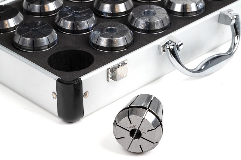

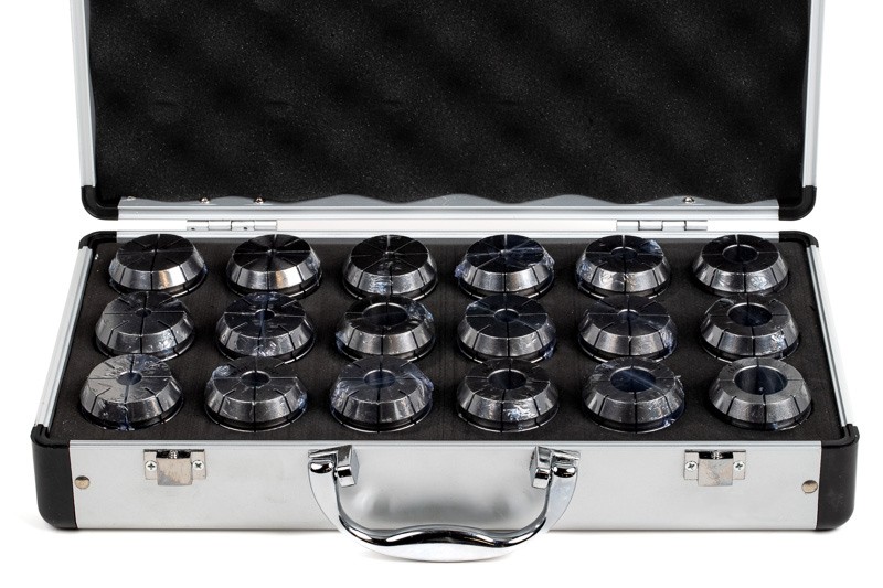

This 18-piece, ER40 inch tap collet set covers tap sizes from #0 to 1". The collets have a 0.0004" - 0.0006" TIR, and are defined by collet class 1 per DIN ISO 15488. These collets have no clamping range; the collet bores are the exact tool diameter, with a square drive that locks the flat-sided tap shanks into the collet, providing maximum concentricity, with positive driving force. Included sizes: #0 to #6, #8, #10, #12, 1/8" NPT, 1/4" NPT, 1/4", 5/16", 3/8" NPT, 3/8", 7/16", 1/2" NPT, 1/2", 9/16", 5/8", 3/4", 7/8", 1".
