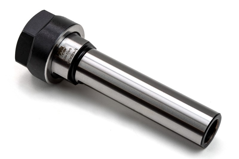

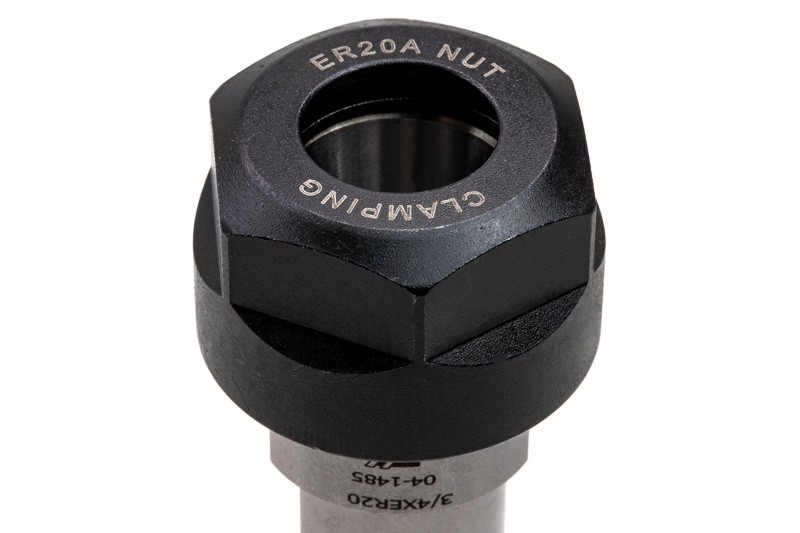

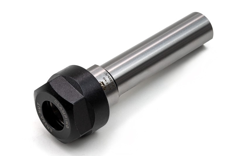

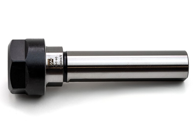

ER20 3/4" Straight Shank Collet Chuck, TSC
Part #: 04-1485
ST SHANK COLLET CHUCK 3/4" X ER20
Price: 69.95 ( / unit)
This straight shank ER20 collet chuck accepts a variety of ER20 collet styles, and has a 0.75 in \ 3/4" shank. The precision cylindrical shank has one flat, and will mount into any internal (ID) turning holder with the appropriate bore size and set-screw clamping. The double-taper collet design provides high clamping force for round, smooth shank tools, and offers a wide gripping range with excellent TIR and balance. The collet chuck is through-tool coolant (TSC) capable, and also may be used as an extended-length milling collet, by clamping it into the appropriate end mill holder.
Collet Series ER-20
[ØBD] Body Diameter 1.34 in
[ØDMM] Shank Diameter 0.75 in \ 3/4"
[LS] Shank Length 2.95 in
[LSCX] Maximum Clamping Length 3.71 in
[OAL] Overall Length 4.39 in
[FS] Flat Size 0.71 in
[TP1] Thread M12x1.0
Through Tool Coolant Yes
Weight 0.7 lbs \ 0.3 kg
