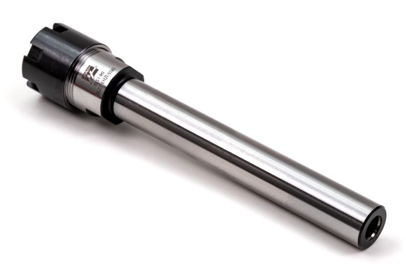

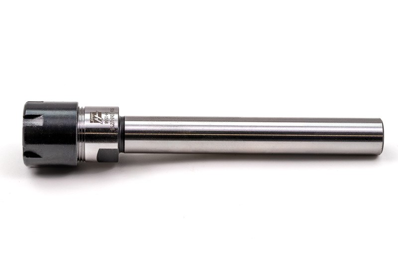

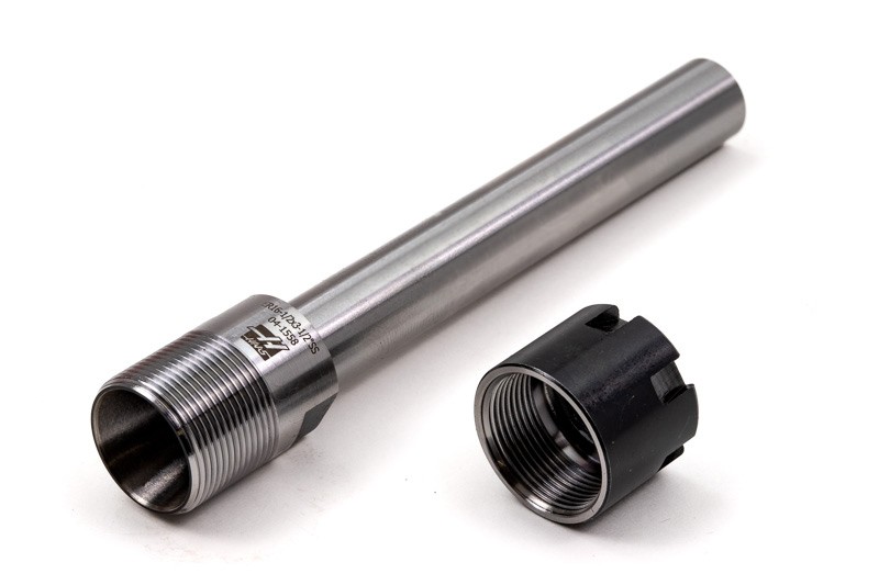

ER16M 1/2" Straight Shank Collet Chuck x 3.5" Short Shank Length, TSC
Part #: 04-1558
ER16-1/2x3-1/2"SS
Price: 52.95 ( / unit)
This straight shank ER16M collet extension accepts a variety of ER16M collet styles, and has a 0.5 in \ 1/2" shank, with a 3.5 in \ 3-1/2" short shank length. It is primarily used as an extended-length milling collet, by clamping it into the appropriate end mill holder. The double-taper collet design provides high clamping force for round, smooth shank tools, and offers a wide gripping range with excellent TIR and balance.
Collet Series ER-16
[ØBD] Body Diameter 0.866 in
[ØDMM] Shank Diameter 0.5 in \ 1/2"
[LS] Shank Length 3.5 in
[OAL] Overall Length 4.92 in
[FS] Flat Size 0.334 in
[TP1] Thread M6X1.0
Concentricity 0.0004"
Through Tool Coolant Yes
Weight 0.3 lbs \ 0.1 kg
