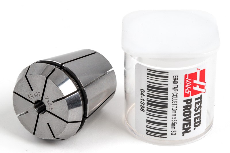

ER40 M10 Tap Collet, 7mm Bore Diameter x 5.5mm Square
Part #: 04-1336
ER40-M10 TAP COLLET 7MM X 5.5MM

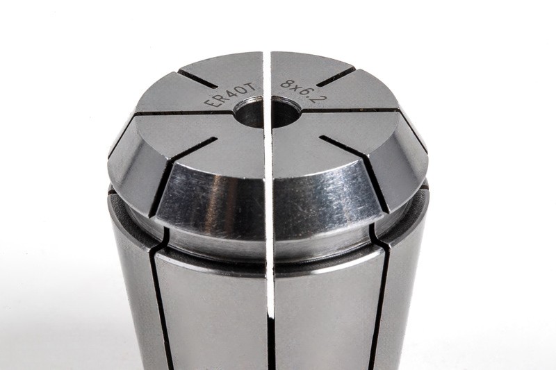

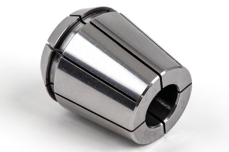

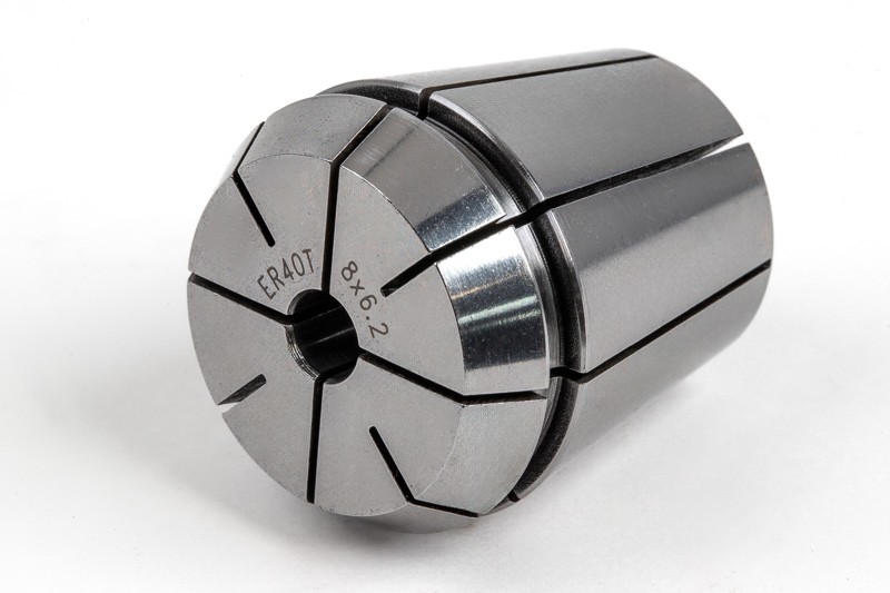

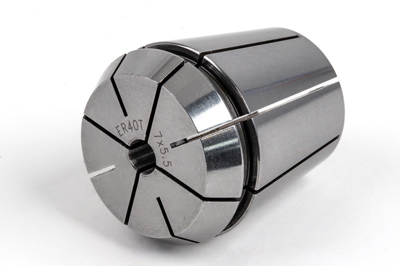

This ER40 tap collet for M10 taps has a 7mm bore diameter and a 5.5mm built-in square drive to securely grip flat-sided tap shanks, providing the extra torque required for tapping. It has a 0.01mm TIR, and is defined by collet class 1, per DIN ISO 15488. This collet has no clamping range; the tool shank must be the exact diameter of the collet bore.
Collet Series ER-40
Collet Class Class 1
Type Tap Collet
Tap Size M10
[ØD] Bore Diameter 7.0 mm
[LSC] Clamping Length 22.0 mm
[SS] Square Size 5.5 mm
Total Indicator Runout (TIR) 0.01 mm
Weight 0.6 lbs \ 0.3 kg
