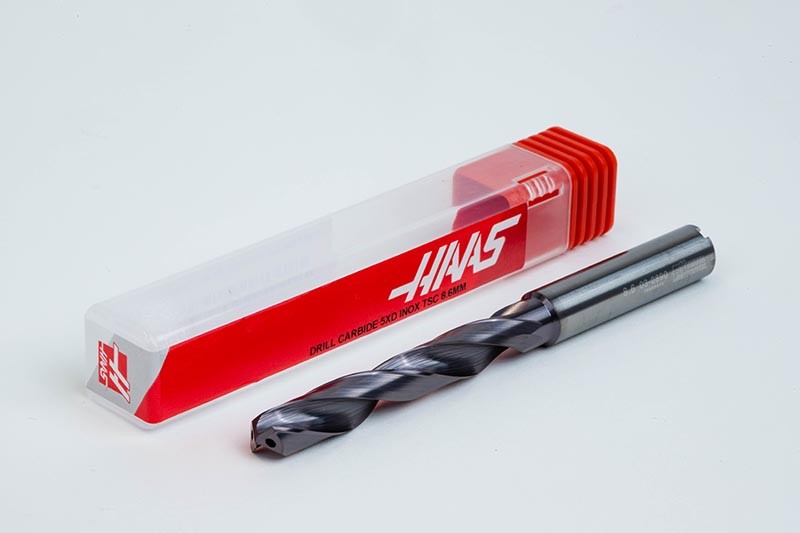

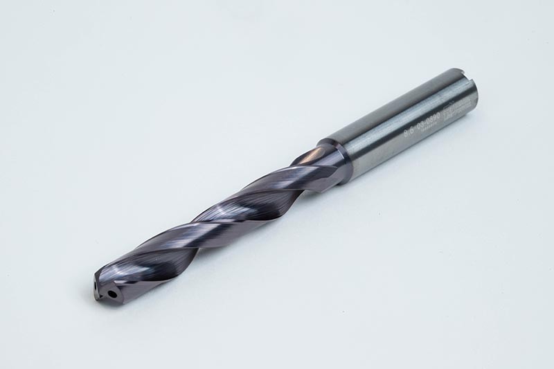

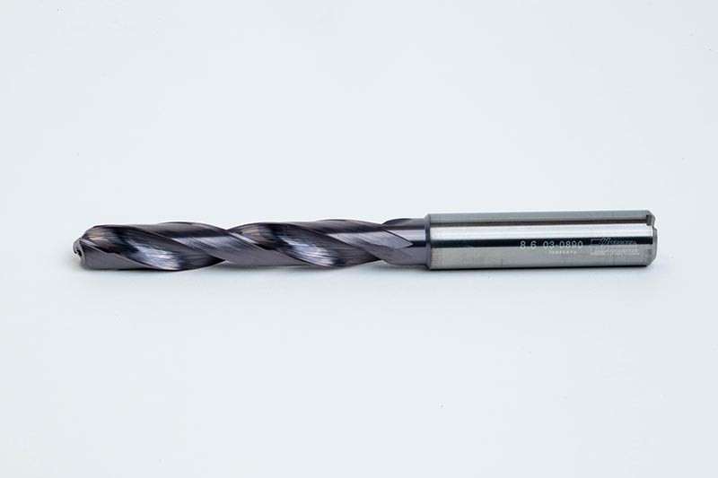

8.6mm Ø Carbide Drill, 10mm Shank x 140° Point Angle x 30° Helix, 5XD, 2 Flute, TiAlN Coated, Inox / SS, TSC
Part #: 03-0890
DRILL CARBIDE 5XD INOX TSC 8.6MM
Price: 77.95 ( / unit)
Price: 948.95 ( / unit)
Price: 282.95 ( / unit)
Price: 37.95 ( / unit)
Price: 170.95 ( / unit)
Price: 398.95 ( / unit)
54.97
  • Speeds and Feeds
ISO MATERIAL CHART
Drill Type Decimal
[D1] Drill Diameter 8.6 mm
Primary Workpiece Material N - Aluminum, P - Steel, M - Stainless Steel
Material Carbide
Chipbreaker Inox / SS - Stainless Steel
Coating TiAlN
[ØDMM] Shank Diameter 10.0 mm
[LU] Usable Length 49.0 mm
[LCF] Flute Length 61.0 mm
[PL] Point Length 1.57 mm
[OAL] Overall Length 103.0 mm
[NOF] Number of Flutes 2
[SIG°] Point Angle 140
[FHA°] Helix Angle 30
Length / Diameter 5 X D
Hole Tolerance m7
Cutting Direction Right
Through Spindle Coolant Yes
Weight 0.2 lbs \ 0.1 kg
