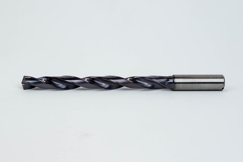

12.2mm Ø Carbide Drill, 14mm Shank x 140° Point Angle x 30° Helix, 8XD, 2 Flute, TiAlN Coated, Inox / SS, TSC
Part #: 03-0950
DRILL CARBIDE 8XD INOX TSC 12.2MM
Price: 241.95 ( / unit)
Price: 2898.95 ( / unit)
Price: 862.95 ( / unit)
Price: 115.95 ( / unit)
Price: 521.95 ( / unit)
Price: 1217.95 ( / unit)
145.97
2774.97
825.97
110.97
499.97
1165.97
  • Speeds and Feeds
ISO MATERIAL CHART
Drill Type Decimal
[D1] Drill Diameter 12.2 mm
Primary Workpiece Material M - Stainless Steel, N - Aluminum, P - Steel
Material Carbide
Chipbreaker Inox / SS - Stainless Steel
Coating TiAlN
[ØDMM] Shank Diameter 14.0 mm
[LU] Usable Length 112.0 mm
[LCF] Flute Length 133.0 mm
[PL] Point Length 2.22 mm
[OAL] Overall Length 178.0 mm
[NOF] Number of Flutes 2
[SIG°] Point Angle 140
[FHA°] Helix Angle 30
Length / Diameter 8 X D
Hole Tolerance m7
Cutting Direction Right
Through Spindle Coolant Yes
Weight 0.4 lbs \ 0.2 kg
