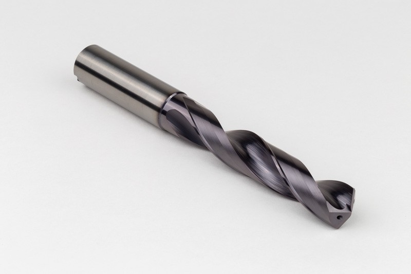

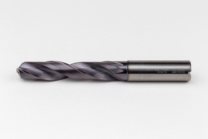

15.1mm Ø Carbide Drill, 16mm Shank x 140° Point Angle x 29° Helix, 5XD, 2 Flute, TiAlN Coated, Inox / SS, TSC
Part #: 03-1445
DRILL CARB 5XD SS TSC 15.1MM
Price: 137.95 ( / unit)
Price: 2073.95 ( / unit)
Price: 617.95 ( / unit)
Price: 82.95 ( / unit)
Price: 373.95 ( / unit)
Price: 870.95 ( / unit)
124.97
  • Speeds and Feeds
ISO MATERIAL CHART
Drill Type Decimal
[D1] Drill Diameter 15.1 mm
Primary Workpiece Material P - Steel, M - Stainless Steel, N - Aluminum
Material Carbide
Chipbreaker Inox / SS - Stainless Steel
Coating TiAlN
[ØDMM] Shank Diameter 16.0 mm
[LU] Usable Length 63.0 mm
[LCF] Flute Length 83.0 mm
[PL] Point Length 2.75 mm
[OAL] Overall Length 133.0 mm
[NOF] Number of Flutes 2
[SIG°] Point Angle 140
[FHA°] Helix Angle 29
Length / Diameter 5 X D
Hole Tolerance m7
Cutting Direction Right
Through Spindle Coolant Yes
Weight 0.5 lbs \ 0.2 kg
