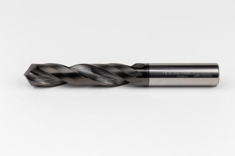

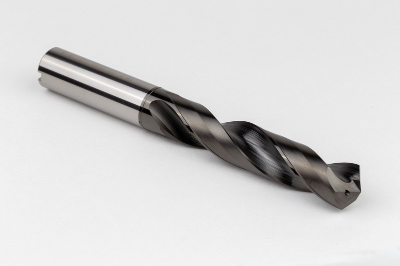

16mm Ø Carbide Drill, 16mm Shank x 118° Point Angle x 30° Helix, 5XD, 2 Flute, DLC Coated, AL, TSC
Part #: 03-1546
DRILL CARB 5XD ALUM DLC TSC 16.0MM
Price: 225.95 ( / unit)
Price: 2648.95 ( / unit)
Price: 788.95 ( / unit)
Price: 105.95 ( / unit)
Price: 476.95 ( / unit)
Price: 1112.95 ( / unit)
180.97
  • Speeds and Feeds
ISO MATERIAL CHART
Drill Type Decimal
[D1] Drill Diameter 16.0 mm
Material Carbide
Chipbreaker AL - Aluminum
Coating DLC
[ØDMM] Shank Diameter 16.0 mm
[LU] Usable Length 63.0 mm
[LCF] Flute Length 83.0 mm
[PL] Point Length 2.91 mm
[OAL] Overall Length 133.0 mm
[NOF] Number of Flutes 2
[SIG°] Point Angle 118
[FHA°] Helix Angle 30
Length / Diameter 5 X D
Hole Tolerance m7
Cutting Direction Right
Through Spindle Coolant Yes
Weight 0.5 lbs \ 0.2 kg
