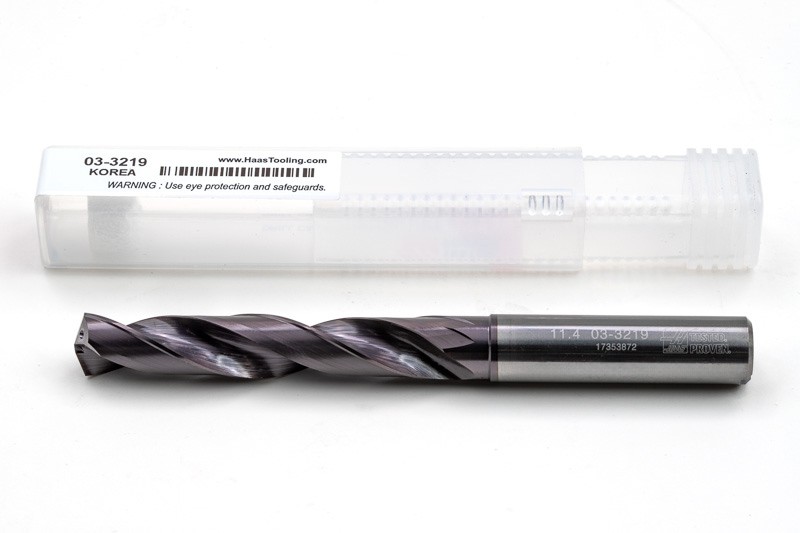

11.4mm Ø Carbide Drill, 12mm Shank x 140° Point Angle x 30° Helix, 5XD, 2 Flute, TiAlN Coated, Inox / SS, TSC
Part #: 03-3219
DRILL CARBIDE 5XD TSC 11.4MM
Price: 88.95 ( / unit)
Price: 1898.95 ( / unit)
Price: 565.95 ( / unit)
Price: 75.95 ( / unit)
Price: 341.95 ( / unit)
Price: 797.95 ( / unit)
71.97
  • Speeds and Feeds
ISO MATERIAL CHART
Drill Type Decimal
[D1] Drill Diameter 11.4 mm
Thread Size M12x1.5
Primary Workpiece Material M - Stainless Steel, P - Steel, N - Aluminum
Material Carbide
Chipbreaker Inox / SS - Stainless Steel
Coating TiAlN
[ØDMM] Shank Diameter 12.0 mm
[LU] Usable Length 40.0 mm
[LCF] Flute Length 55.0 mm
[PL] Point Length 2.1 mm
[OAL] Overall Length 118.0 mm
[NOF] Number of Flutes 2
[SIG°] Point Angle 140
[FHA°] Helix Angle 30
Length / Diameter 5 X D
Hole Tolerance m7
Cutting Direction Right
Through Spindle Coolant Yes
Weight 0.3 lbs \ 0.1 kg
