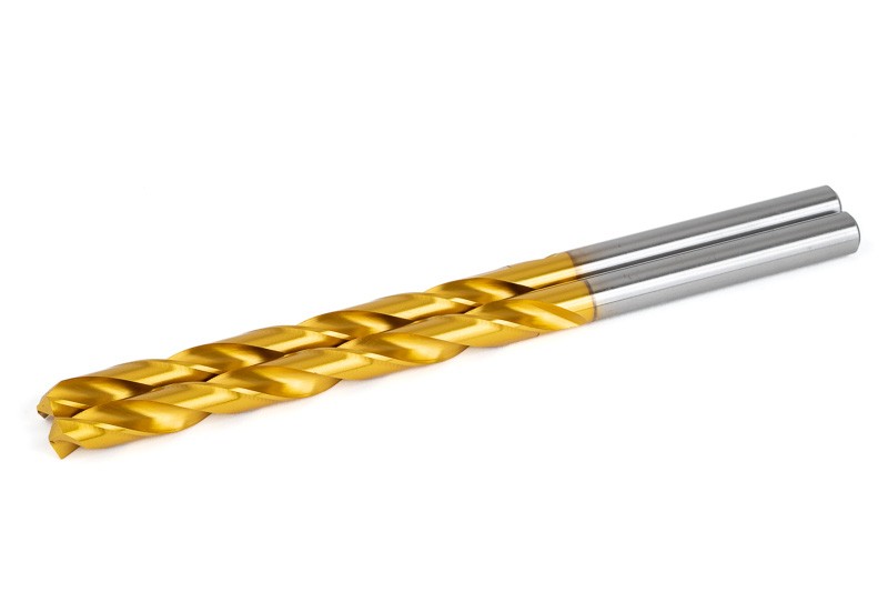

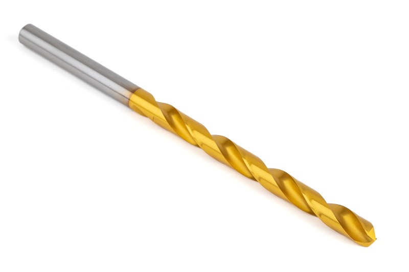

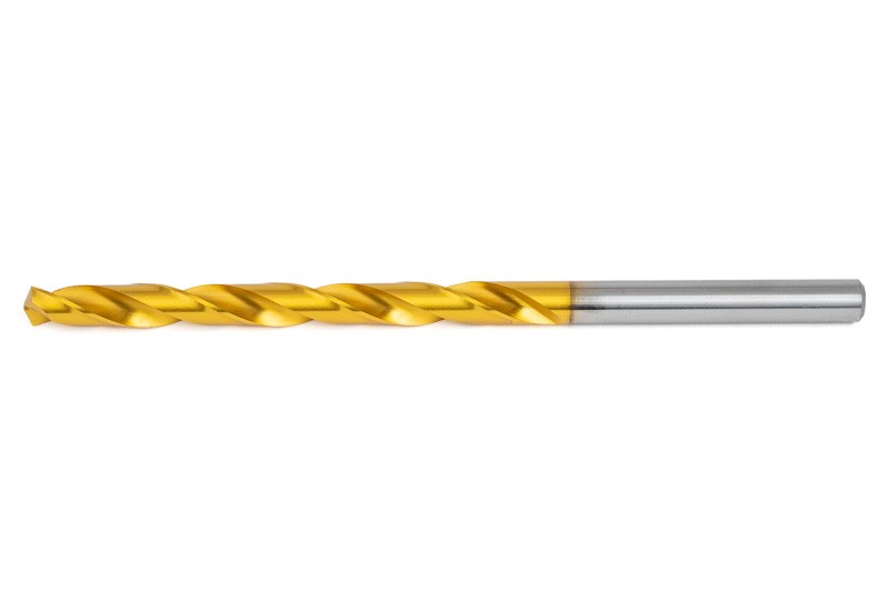

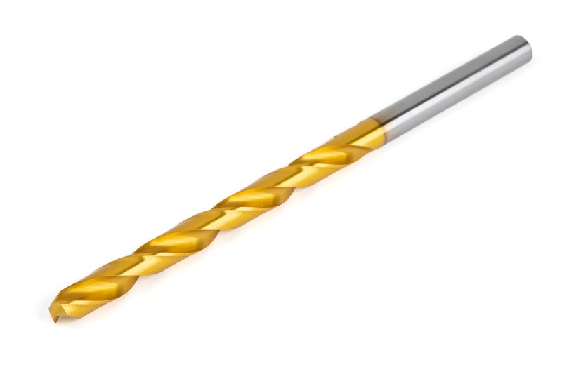

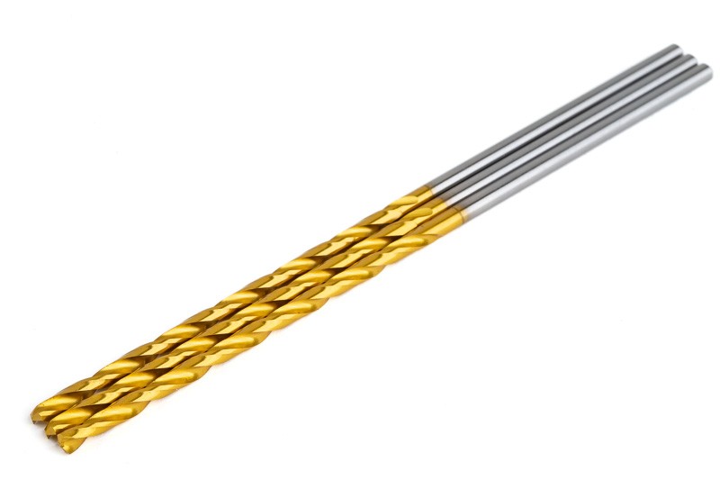

1/8" Ø Cobalt Taper-Length Drill, 135° Point Angle x 30° Helix, 2 Flute, TiN Coated - Pack of 3
Part #: 03-2522
CB TD 2FL 1/8x.125x2-3/4x5-1/8 TIN
Price: 20.95 ( / unit)
15.97
  • Speeds and Feeds
ISO MATERIAL CHART
Drill Type Fraction
Secondary Workpiece Material S - High Temp Alloys, K - Cast Iron, N - Aluminum
Material HSSCo8 (M42)
Coating TiN
[D1] Drill Diameter 0.125 in \ 1/8"
[ØDMM] Shank Diameter 0.125 in
[LU] Usable Length 2.625 in
[LCF] Flute Length 2.75 in
[PL] Point Length 0.026 in
[OAL] Overall Length 5.125 in
[NOF] Number of Flutes 2
[SIG°] Point Angle 135
[FHA°] Helix Angle 30
Drill Length Type Taper
Hole Tolerance h8
Cutting Direction Right
Through Spindle Coolant No
