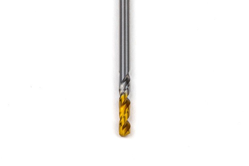

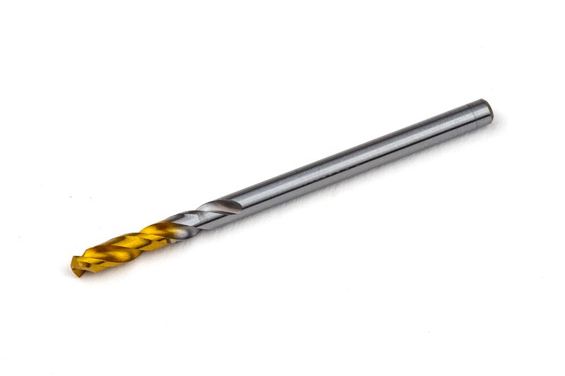

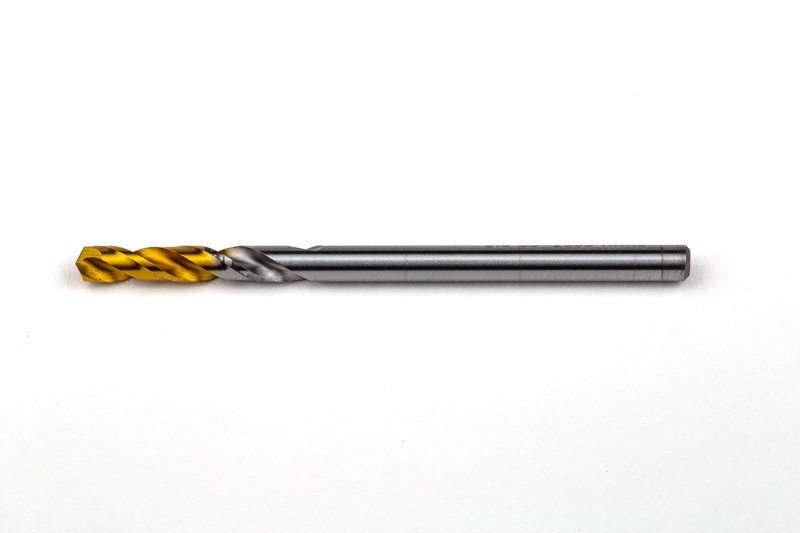

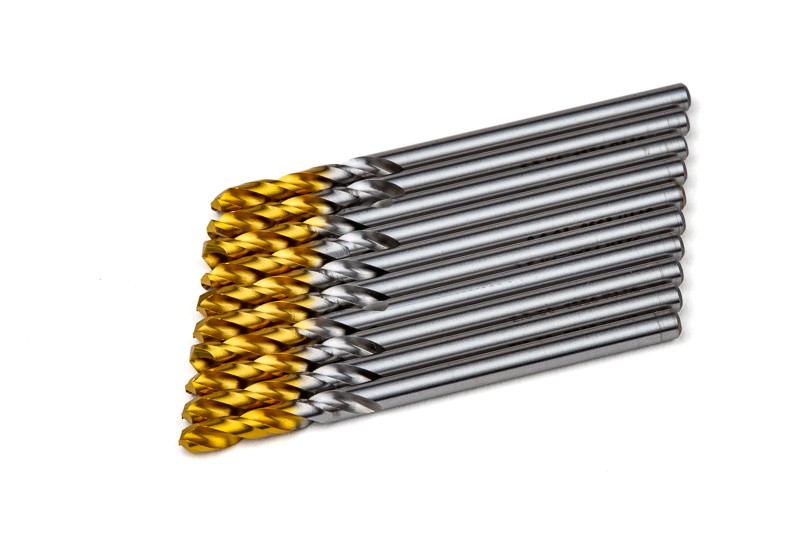

  • Speeds and Feeds
ISO MATERIAL CHART
Drill Type Decimal
Primary Workpiece Material M - Stainless Steel, P - Steel
Secondary Workpiece Material K - Cast Iron, S - High Temp Alloys, N - Aluminum
Material HSSCo8 (M42)
Coating TiN
[D1] Drill Diameter 2.8 mm
[ØDMM] Shank Diameter 2.8 mm
[LU] Usable Length 13.2 mm
[LCF] Flute Length 16.0 mm
[PL] Point Length 0.58 mm
[OAL] Overall Length 46.0 mm
[NOF] Number of Flutes 2
[SIG°] Point Angle 135
[FHA°] Helix Angle 33
Drill Length Type Stub
Hole Tolerance h8
Cutting Direction Right
Through Spindle Coolant No
