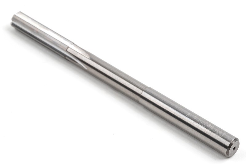

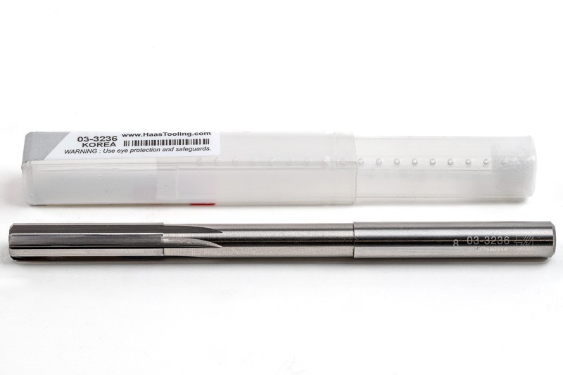

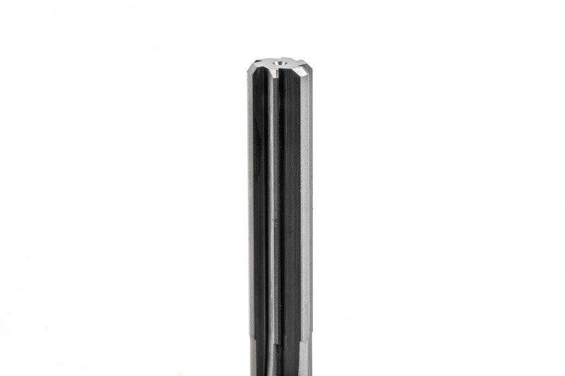

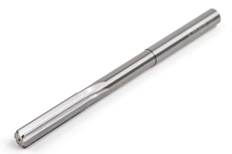

8.000mm Ø Straight Flute Carbide Reamer, 8.000mm Shank x 45° Chamfer Angle, 6 Flute, Right-Hand
Part #: 03-3236
REAMER SF RHC 8.0mm CARBIDE
Price: 75.95 ( / unit)
Price: 1623.95 ( / unit)
Price: 483.95 ( / unit)
Price: 64.95 ( / unit)
Price: 292.95 ( / unit)
Price: 681.95 ( / unit)
53.97
1149.97
342.97
45.97
206.97
482.97
  • Technical Details
ISO Material Chart
Secondary Workpiece Material M - Stainless Steel, N - Aluminum
Flute Type Straight Flute
[ØDC] Cutting Diameter 8.0 mm
[ØDMM] Shank Diameter 8.0 mm
[ØN] Neck Diameter 7.5 mm
[LU] Usable Length 74.0 mm
[LN] Neck Length 41.0 mm
[LCF] Flute Length 33.0 mm
[OAL] Overall Length 117.0 mm
[NOF] Number of Flutes 6
[SIG°] Chamfer Angle 45 Degree
Hole Tolerance +.015/-.000 mm
Shank Tolerance +.0/-0.009 mm
Cutting Direction Right
Through Spindle Coolant No
Weight 0.2 lbs \ 0.1 kg
