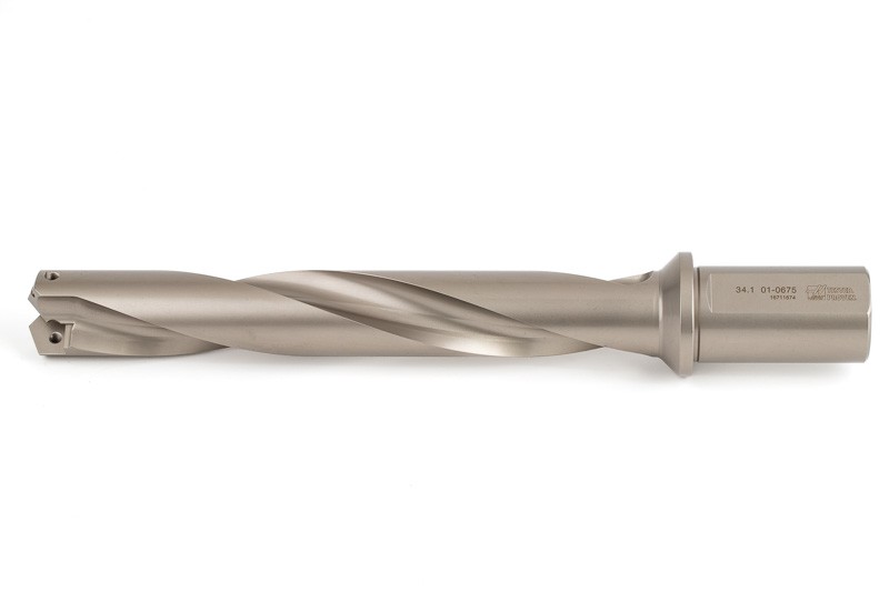

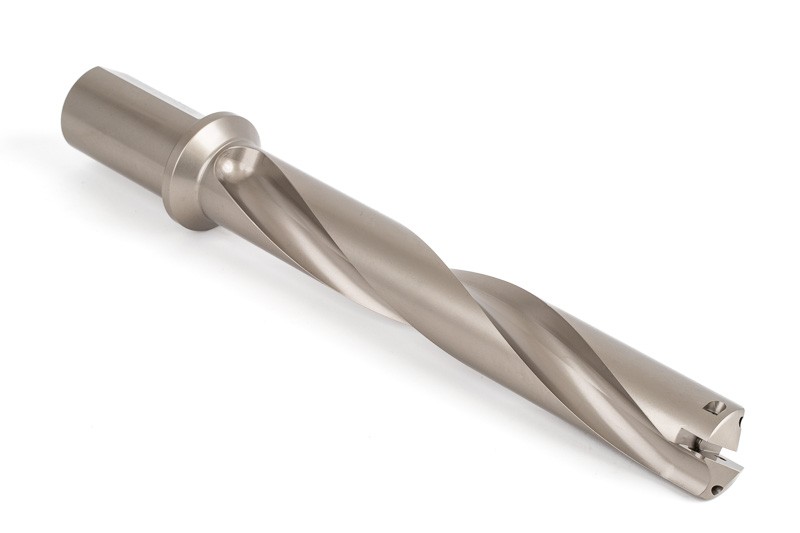

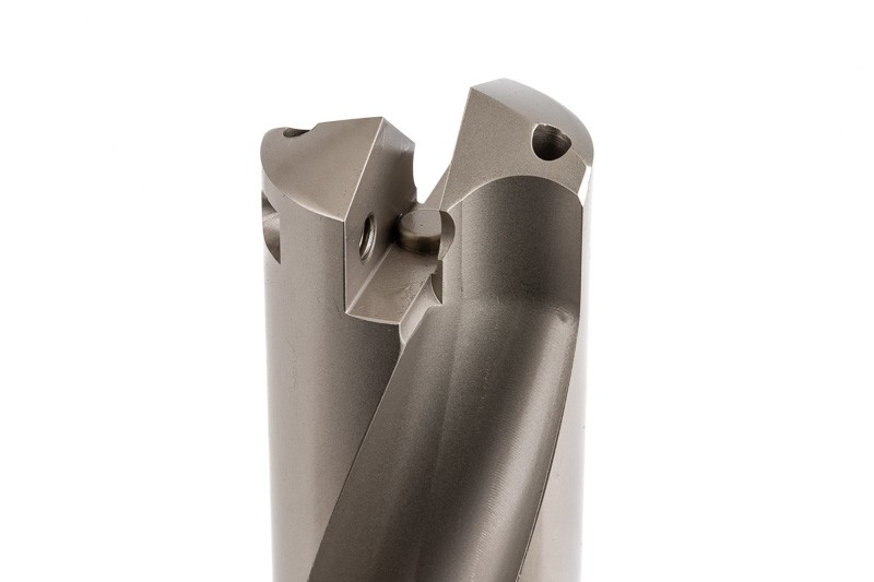

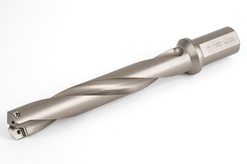

HSD5, 1.406" Ø Spiral Flute Spade Drill Body, 1-1/2" Shank, 5XD, Insert Seat Size 3, TSC
Part #: 01-0675
SPD3HF1.406-1.875X1-1/2X8-1/4X13"WFC
Price: 587.95 ( / unit)
411.97
High-Speed Peck Drilling
Insert Size 3 - (1.406in thru 1.875in)

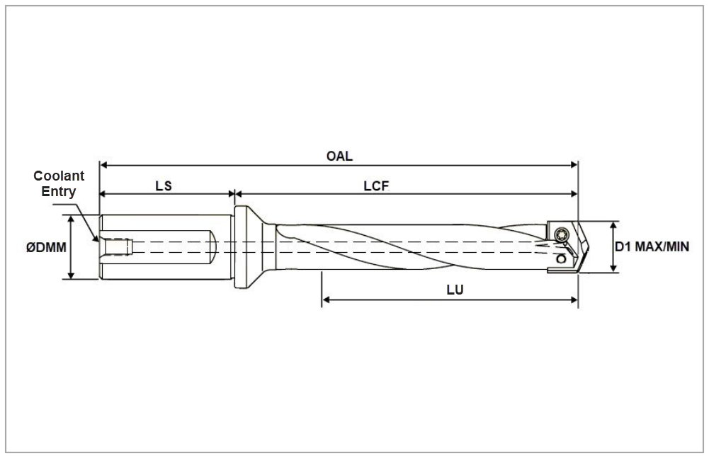

[D1MIN] Minimum Drill Diameter 1.406 in
[D1MAX] Maximum Drill Diameter 1.875 in
Flute Type Spiral
Length / Diameter 5 X D
[LU] Usable Length 8.25 in
Drilling Cutter Series HSD - Haas Spade Drill
[ØDMM] Shank Diameter 1.5 in
[LCF] Flute Length 10.312 in
[LS] Shank Length 2.687 in
[OAL] Overall Length 13.0 in
Coolant Entry Thread Size 1/4" NPT
Through Spindle Coolant Yes
Weight 4.0 lbs \ 1.8 kg
