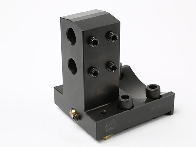

BOT20, 3/4" Ø Internal (ID) Extended Twin Static Turning Holder
Part #: 04-0760
BOT20EXTID-3/4T
Price: 635.95 ( / unit)
349.97
This BOT20 internal (ID) extended twin static turning holder securely clamps 0.75 in \ 3/4" round shank tools for use in Haas machines equipped with 12-station BOT20 bolt-on or 12-station VB20/30 hybrid (BOT20/VDI40) turrets.
Extended Length Double 20 mm ID Boring Bar Static Toolholder for Hybrid or Bolt-On Turrets. Provides additional clearance for drills and boring bars for main spindle operations. Includes coolant nozzles and all necessary hardware.
  • Holds up to two tools with 20 mm shank
  • Industry-standard bolt pattern
  • Black oxide coating for corrosion resistance
  • Haas-designed OEM tooling
  • 3D Model
Machine Models ST-25LY, ST-20LY, ST-28Y, ST-25L, ST-28, ST-30, ST-30Y, ST-25, ST-20, ST-25Y, ST-20Y, ST-28LY, ST-20L, ST-30L, ST-30LY, ST-35, ST-35Y, ST-28L, ST-35L, ST-35LY
Turret Style VB Hybrid, Bolt-On
Turret Stations 12-Station
Main Spindle Turret VB20/30, BOT20
Sub-Spindle Turret BOT20, VB20/30
Toolholder Series BOT20
Holder Type Internal Turning
[S] Tool Shank Size 0.75 in \ 3/4"
[H] Height 3.0 in
[BH] Body Height 5.25 in
[OAL] Overall Length 4.75 in
[OAW] Overall Width 4.0 in
[OAH] Overall Height 5.5 in
[a] Dimension 1.772 in
[b] Dimension 3.15 in
[c] Dimension 1.0 in
[d] Dimension 1.5 in
[TP1] Thread 1/2"-13
[TP2] Thread 7/16"-14
Weight 6.6 lbs \ 3.0 kg
