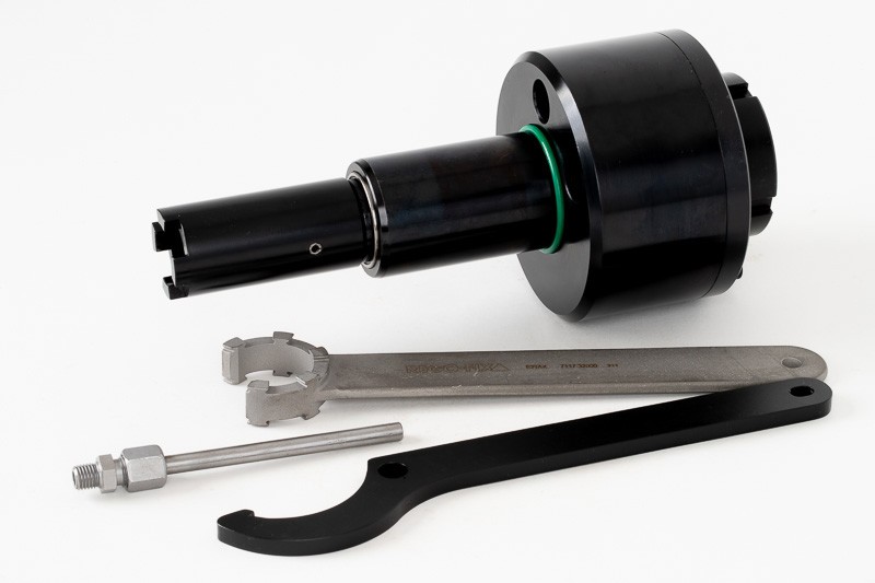

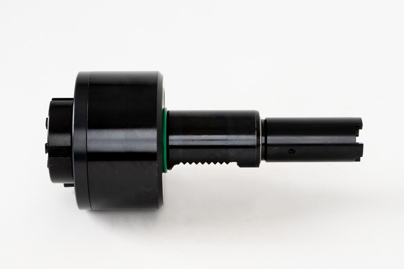

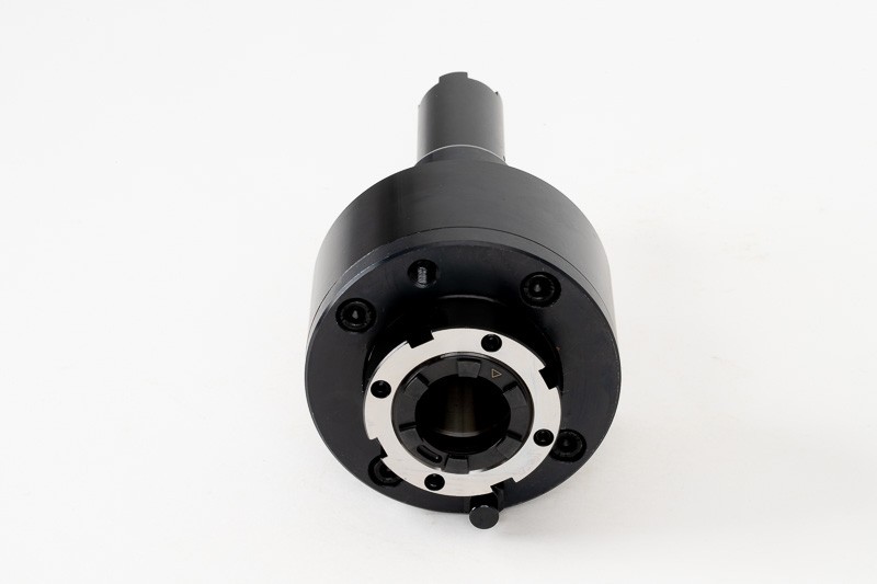

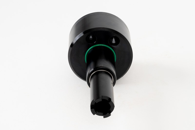

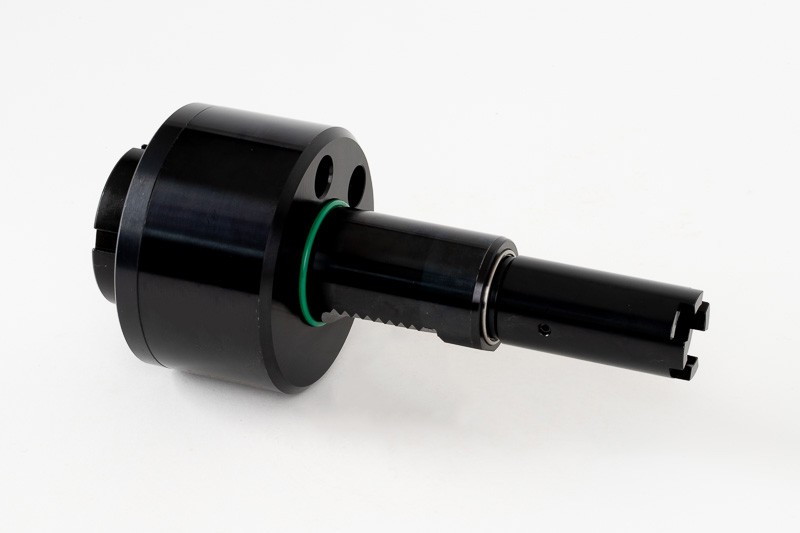

This VDI40 ER32 straight axial extended live/driven turning holder by EXSYS/Eppinger accepts a variety of ER32 collet styles, for use in Haas machines equipped with 12-station VB40 hybrid (BOT40/VDI40) turrets. The double-taper collet design provides high clamping force for round, smooth shank tools, and offers a wide gripping range with excellent TIR and balance.
**For legacy Haas HL, SL, ST, and TL machines, verify the 'a dimension' specification accurately locates the VDI40 holder shank to the turret's gear drive system.
Refer to the Lathe Toolholder Selection Chart to ensure your machine turret matches.
  • Technical Documents
  • Driven (Live) Tool Heads
  • Warranty Information
System of Measurement Metric - ISO, Inch - ANSI
Machine Models ST-40L, ST-45L, ST-45, ST-40
Turret Style VB Hybrid
Turret Stations 12-Station
Main Spindle Turret VB40
Toolholder Series VDI40 Extended Coupling
Holder Type Straight
Collet Series ER-32
[H] Height 2.957 in / 75.1 mm
[BH] Body Height 2.205 in / 56.0 mm
[OAL] Overall Length 3.622 in / 92.0 mm
[OAW] Overall Width 3.622 in / 92.0 mm
[OAH] Overall Height 8.085 in / 205.35 mm
[a] Dimension 2.648 in / 67.25 mm
Maximum RPM 4000
Brand EXSYS Eppinger
Weight 17.8 lbs \ 8.1 kg
Country of Origin Germany
