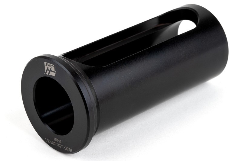

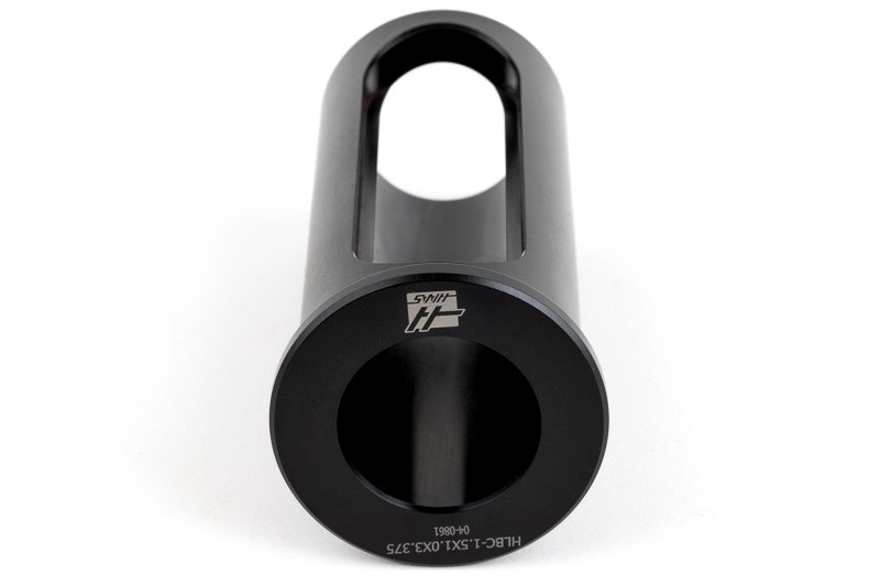

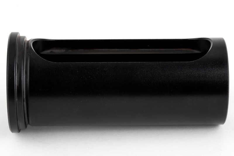

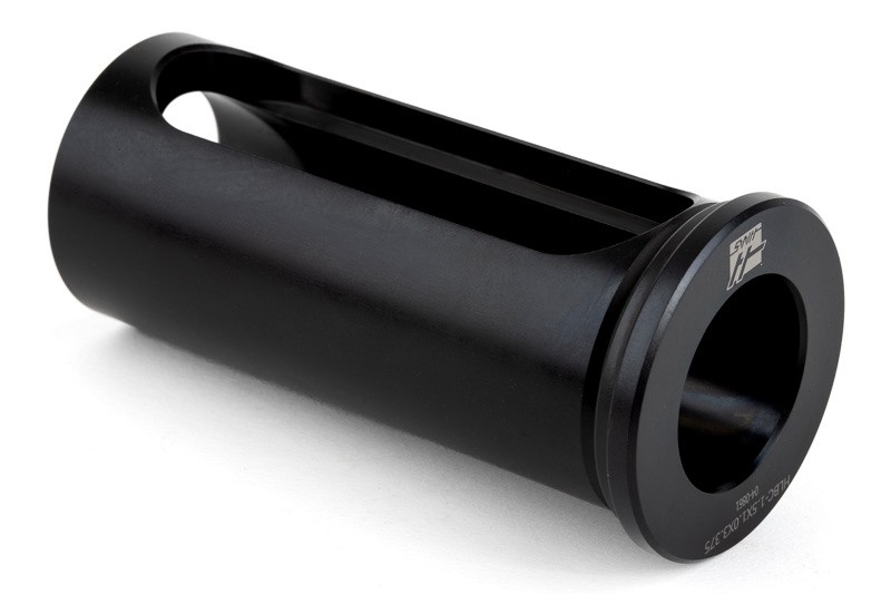

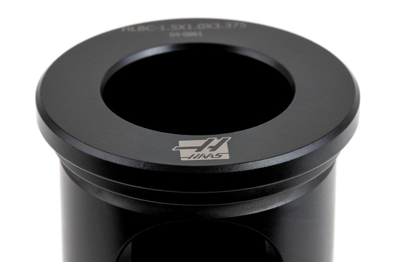

C-Type Reduction Sleeve, 1-1/2" Shank x 1" Bore
Part #: 04-0861
HLBC-1.5X1.0X3.375
Price: 73.95 ( / unit)
36.97
This C-type reduction sleeve/bushing has a 1.5 in \ 1-1/2" shank, and is used to expand the working range of your turning holders by securely clamping on smaller, 1.0 in \ 1" round shank, internal (ID) turning tools. It is black oxide coated, for improved corrosion resistance.
Please note: The reduction sleeves shank length [LS] may be too long for through-tool coolant applications on some holders.
Type C
Coating Black Oxide
[ØDMM] Shank Diameter 1.5 in \ 1-1/2"
[ØD] Bore Diameter 1.0 in \ 1"
[Ød1] Diameter 1.725 in
[LS] Shank Length 3.375 in
[OAL] Overall Length 3.64 in
[W] Width 0.874 in
[a] Dimension 2.125 in
[b] Dimension 0.562 in
Weight 0.7 lbs \ 0.3 kg
