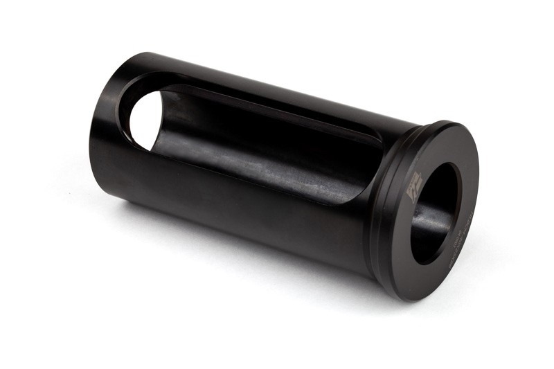

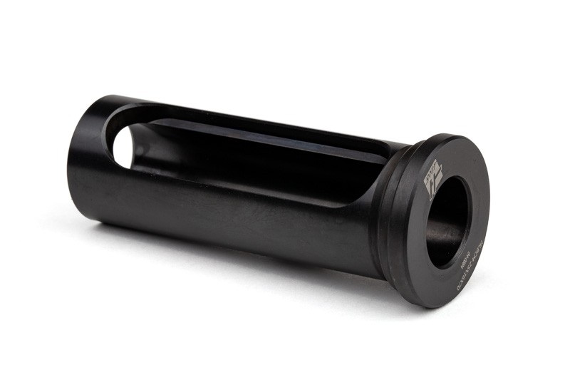

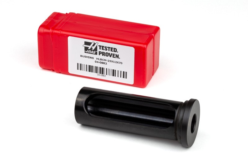

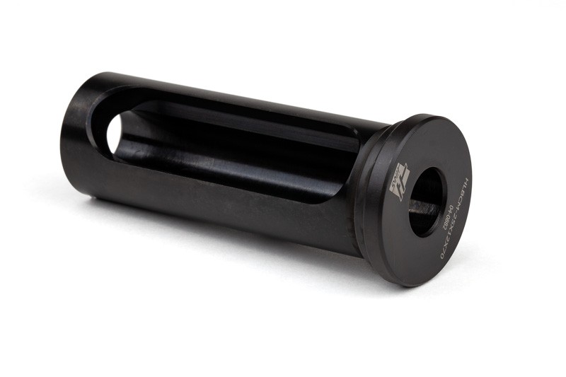

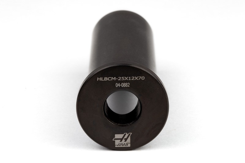

This C-type reduction sleeve/bushing has a 25mm shank, and is used to expand the working range of your turning holders by securely clamping on smaller, 12mm round shank, internal (ID) turning tools. It is black oxide coated, for improved corrosion resistance.
Please note: The reduction sleeves shank length [LS] may be too long for through-tool coolant applications on some holders.
Type C
Coating Black Oxide
[ØDMM] Shank Diameter 25.0 mm
[ØD] Bore Diameter 12.0 mm
[Ød1] Diameter 31.0 mm
[LS] Shank Length 69.9 mm
[OAL] Overall Length 76.6 mm
[W] Width 15.9 mm
[a] Dimension 44.5 mm
[b] Dimension 11.1 mm
Weight 0.4 lbs \ 0.2 kg
