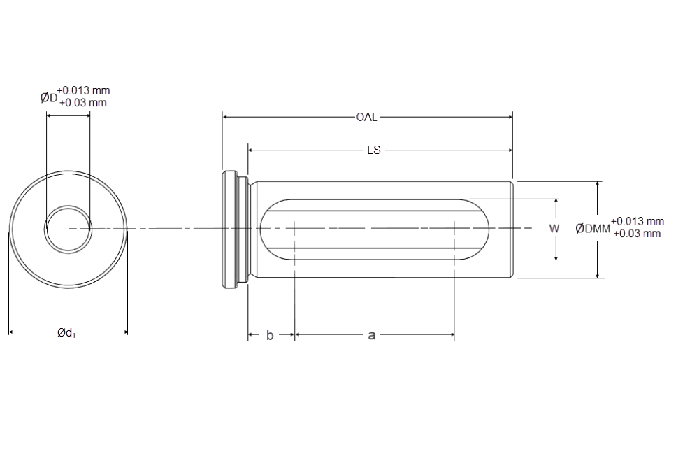

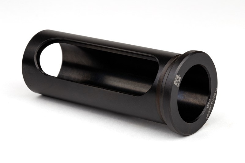

This C-type reduction sleeve/bushing has a 50mm shank, and is used to expand the working range of your turning holders by securely clamping on smaller, 25mm round shank, internal (ID) turning tools. It is black oxide coated, for improved corrosion resistance.
Please note: The reduction sleeves shank length [LS] may be too long for through-tool coolant applications on some holders.
Type C
Coating Black Oxide
[ØDMM] Shank Diameter 50.0 mm
[ØD] Bore Diameter 25.0 mm
[Ød1] Diameter 43.8 mm
[LS] Shank Length 101.6 mm
[OAL] Overall Length 109.3 mm
[W] Width 25.4 mm
[a] Dimension 66.7 mm
[b] Dimension 15.9 mm
Weight 1.0 lbs \ 0.5 kg
