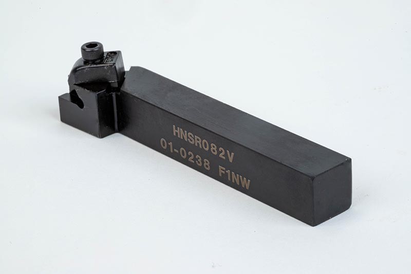

HNSR082V, 1/2" Square Steel Shank External (OD) Haas Notch Grooving/Threading Tool, Right-Hand, Insert Size 2
Part #: 01-0238
RETAIL PRICE: $80.95
$72.97

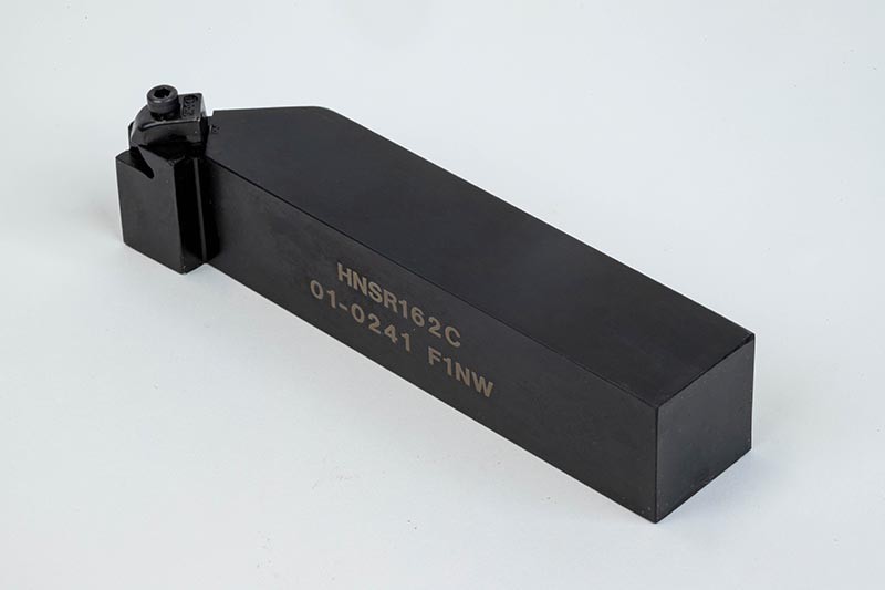

HNSR162D, 1" Square Steel Shank External (OD) Haas Notch Grooving/Threading Tool, Right-Hand, Insert Size 2
Part #: 01-0241
RETAIL PRICE: $92.95
$79.97

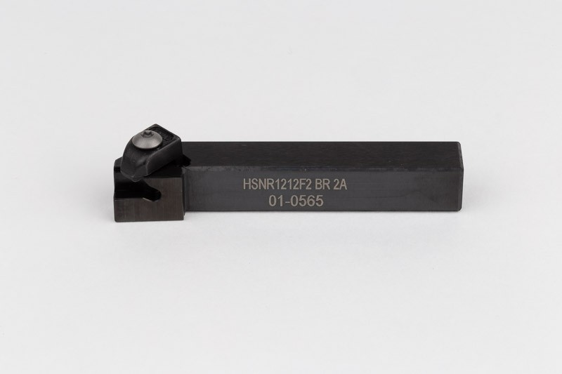

HNSR1212F2, 12mm Square Steel Shank External (OD) Haas Notch Grooving/Threading Tool, Right-Hand, Insert Size 2
Part #: 01-0565
RETAIL PRICE: $104.95 $1,873.95 $557.95 $74.95 $337.95 $786.95
$73.97
