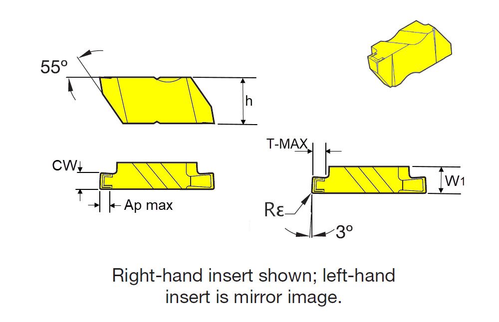

  • Technical Details
ISO Material Chart
Clamping Type HN - Haas Notch
Insert Orientation Internal
Hand of Insert Left
Insert Style Grooving, Profiling
Insert Size 4
Primary Workpiece Material S - High Temp Alloys, M - Stainless Steel, P - Steel
Secondary Workpiece Material H - Hardened Materials, K - Cast Iron, N - Aluminum
Grade HU25
Material Carbide
Chipbreaker K – Standard Chip Control
[h] Insert Height 0.453 in \ 11.51 mm
[CW] Cutting Width 0.189 in \ 4.8 mm
[W1] Insert Width 0.255 in \ 6.48 mm
[RE] Corner Radius 0.023 in \ 0.57 mm
[T-MAX] Maximum Depth 0.25 in \ 6.35 mm
[Ap] Max. Cutting Depth 0.115 in \ 2.92 mm
