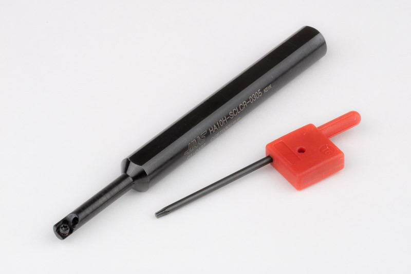

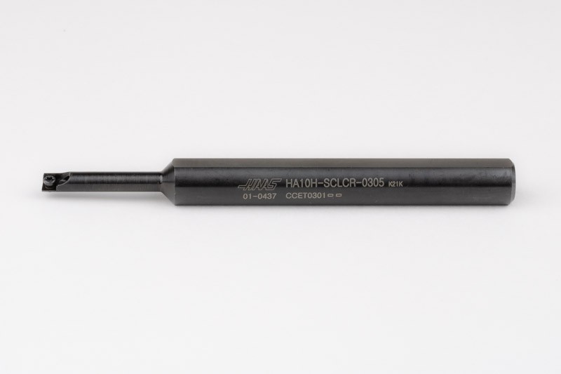

A10H-SCLCR0305, 10mm Ø Steel Shank Internal (ID) Boring Bar, Right-Hand, Screw-Lock, Through-Tool Coolant
Part #: 01-0437
HA10H-SCLCR0305
Price: 48.95 ( / unit)
Price: 798.95 ( / unit)
Price: 237.95 ( / unit)
Price: 31.95 ( / unit)
Price: 143.95 ( / unit)
Price: 335.95 ( / unit)
41.97
699.97
208.97
27.97
125.97
293.97
Type of Bar A - Steel Bar + Coolant
Clamping Type S - Screw-On
Tool Orientation Internal
Hand of Tool Right
Insert Size CCㅁㅁ121ㅁ / CCㅁㅁ0301ㅁㅁ
[ØD] Min. Machining Diameter 5.0 mm
[ØDMM] Shank Diameter 10.0 mm
[LH] Head Length 25.0 mm
[OAL] Overall Length 100.0 mm
[H] Shank Height  9.0 mm
[S] Center to Insert Dimension 2.5 mm
[°] Lead Angle 95 Degree
[IC] Inscribed Circle Diameter 0.138 in \ 3.5 mm
[D1] Insert Hole Size 0.075 in \ 1.9 mm
[L10] Cutting Edge Length 0.138 in \ 3.5 mm
Figure 2
Through Tool Coolant Yes
