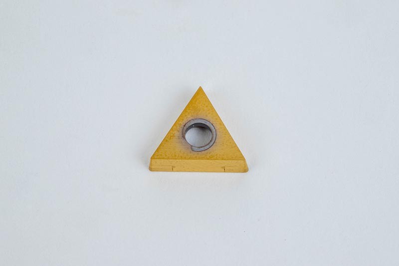

TCGW2151 / TCGW110204, CBN Turning Insert, Triangle, Grade CBNH10C
Part #: 02-0755
3NU-TCGW21.51 SS01225 CBNH10C
Price: 57.95 ( / unit)
Price: 648.95 ( / unit)
Price: 193.95 ( / unit)
Price: 25.95 ( / unit)
Price: 116.95 ( / unit)
Price: 272.95 ( / unit)
40.97
  • Technical Details
ISO Material Chart
Clamping Type S - Screw-On
Insert Style T Style - Triangle
Primary Workpiece Material H - Hardened Steels
Secondary Workpiece Material K - Cast Iron
Grade CBNH10C - Light Interrupted
Material CBN
[IC] Inscribed Circle Diameter 0.25 in \ 6.35 mm
[D1] Insert Hole Size 0.11 in \ 2.8 mm
[L10] Cutting Edge Length 0.433 in \ 11.0 mm
[S] Insert Thickness 0.094 in \ 2.38 mm
[RE] Corner Radius 0.0157 in \ 0.4 mm
