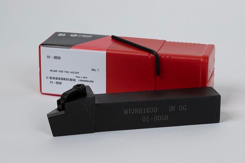

MVJNR16-3D, 1" Square Steel Shank External (OD) Turning Tool, Right-Hand, Multi-Lock
Part #: 01-0058
MVJNR 163D TOOL HOLDER
Price: 94.95 ( / unit)
61.97
Technical Documents

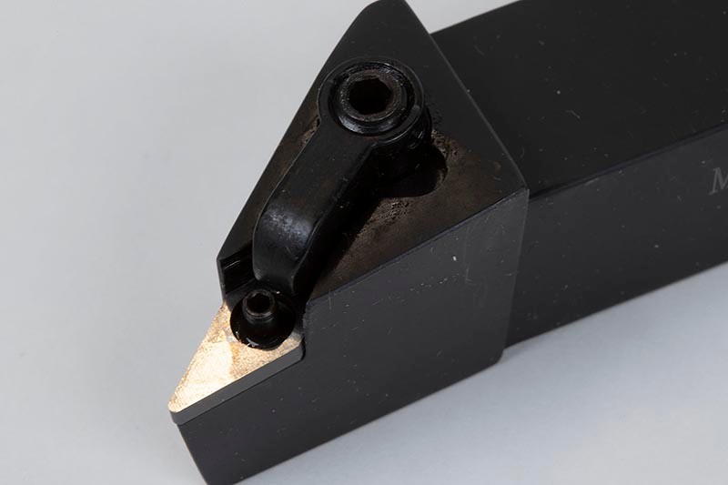

Clamping Type M - Multi-Lock
Insert Style V Style - 35° Rhombic
Tool Orientation External
Hand of Tool Right
[LH] Head Length 1.38 in
[OAL] Overall Length 6.0 in
[H1] Cutting Height 1.0 in
[H] Shank Height 1.0 in
[B] Shank Width 1.0 in
[f] Dimension 1.25 in
[°] Lead Angle 93 Degree
[D1] Insert Hole Size 0.15 in \ 3.81 mm
Machine Side Adapter Type Square Shank
Through Tool Coolant No
Weight 1.4 lbs \ 0.6 kg
Country of Origin India
