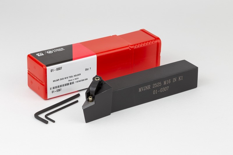

MVJNR2525-M16, 25mm Square Steel Shank External (OD) Turning Tool, Right-Hand, Multi-Lock
Part #: 01-0307
MVJNR 2525 M16
Price: 94.95 ( / unit)
Price: 1473.95 ( / unit)
Price: 438.95 ( / unit)
Price: 58.95 ( / unit)
Price: 265.95 ( / unit)
Price: 618.95 ( / unit)
56.97
1049.97
312.97
41.97
188.97
440.97
Clamping Type M - Multi-Lock
Insert Style V Style - 35° Rhombic
Tool Orientation External
Hand of Tool Right
[LH] Head Length 37.0 mm
[OAL] Overall Length 150.0 mm
[H1] Cutting Height 25.0 mm
[H] Shank Height 25.0 mm
[B] Shank Width 25.0 mm
[f] Dimension 32.0 mm
[°] Lead Angle 93 Degree
[D1] Insert Hole Size 0.15 in \ 3.81 mm
[L10] Cutting Edge Length 0.654 in \ 16.61 mm
Machine Side Adapter Type Square Shank
Through Tool Coolant No
Weight 1.4 lbs \ 0.6 kg
