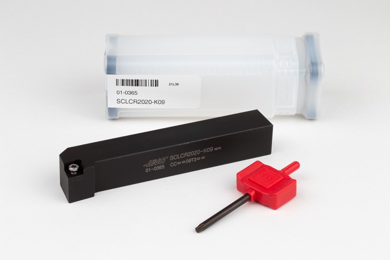

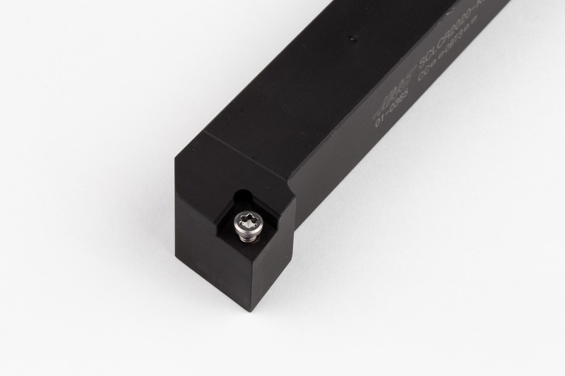

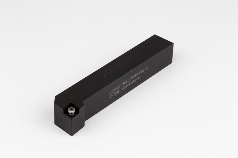

SCLCR2020-K09, 20mm Square Steel Shank External (OD) Turning Tool, Right-Hand, Screw-Lock
Part #: 01-0365
SCLCR2020-K09
Price: 74.95 ( / unit)
Price: 1548.95 ( / unit)
Price: 460.95 ( / unit)
Price: 61.95 ( / unit)
Price: 278.95 ( / unit)
Price: 650.95 ( / unit)
48.97
1099.97
327.97
43.97
197.97
461.97
Technical Documents
Clamping Type S - Screw-On
Tool Orientation External
Hand of Tool Right
[LH] Head Length 16.0 mm
[OAL] Overall Length 125.0 mm
[H1] Cutting Height 20.0 mm
[H] Shank Height 20.0 mm
[B] Shank Width 20.0 mm
[f] Dimension 25.0 mm
[°] Lead Angle 95 Degree
[D1] Insert Hole Size 0.173 in \ 4.4 mm
[L10] Cutting Edge Length 0.381 in \ 9.67 mm
Machine Side Adapter Type Square Shank
Through Tool Coolant No
Weight 0.6 lbs \ 0.3 kg
