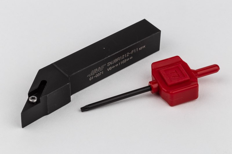

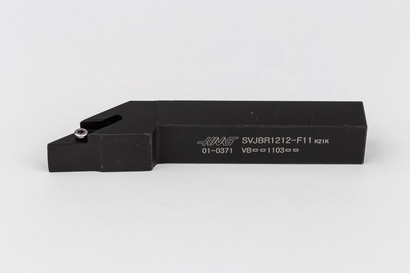

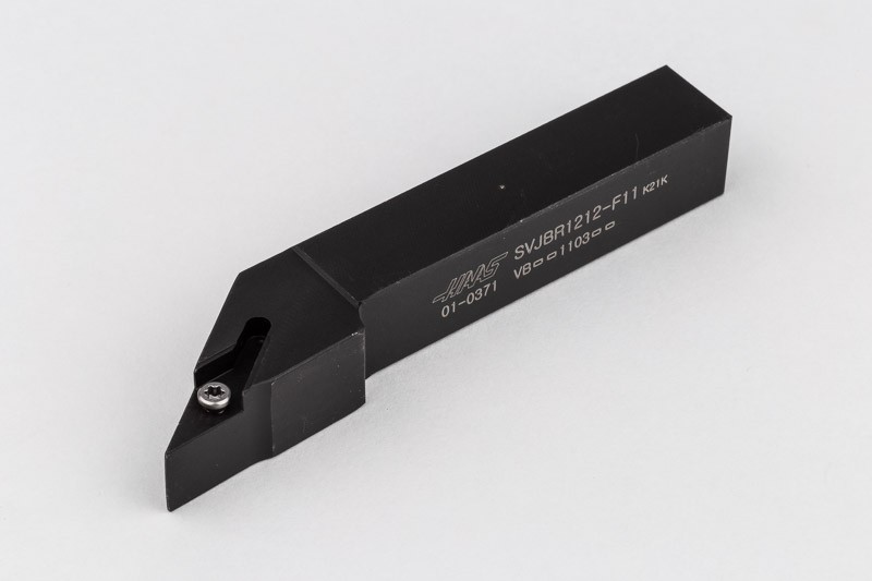

SVJBR1212-F11, 12mm Square Steel Shank External (OD) Turning Tool, Right-Hand, Screw-Lock
Part #: 01-0371
SVJBR1212-F11
Price: 64.95 ( / unit)
Price: 1323.95 ( / unit)
Price: 393.95 ( / unit)
Price: 52.95 ( / unit)
Price: 238.95 ( / unit)
Price: 555.95 ( / unit)
42.97
949.97
282.97
37.97
170.97
398.97
Technical Documents
Clamping Type S - Screw-On
Insert Style V Style - 35° Rhombic
Tool Orientation External
Hand of Tool Right
[LH] Head Length 27.0 mm
[OAL] Overall Length 80.0 mm
[H1] Cutting Height 12.0 mm
[H] Shank Height 12.0 mm
[B] Shank Width 12.0 mm
[f] Dimension 16.0 mm
[°] Lead Angle 93 Degree
[IC] Inscribed Circle Diameter 0.25 in \ 6.35 mm
[D1] Insert Hole Size 0.11 in \ 2.8 mm
[L10] Cutting Edge Length 0.433 in \ 11.0 mm
Machine Side Adapter Type Square Shank
Through Tool Coolant No
