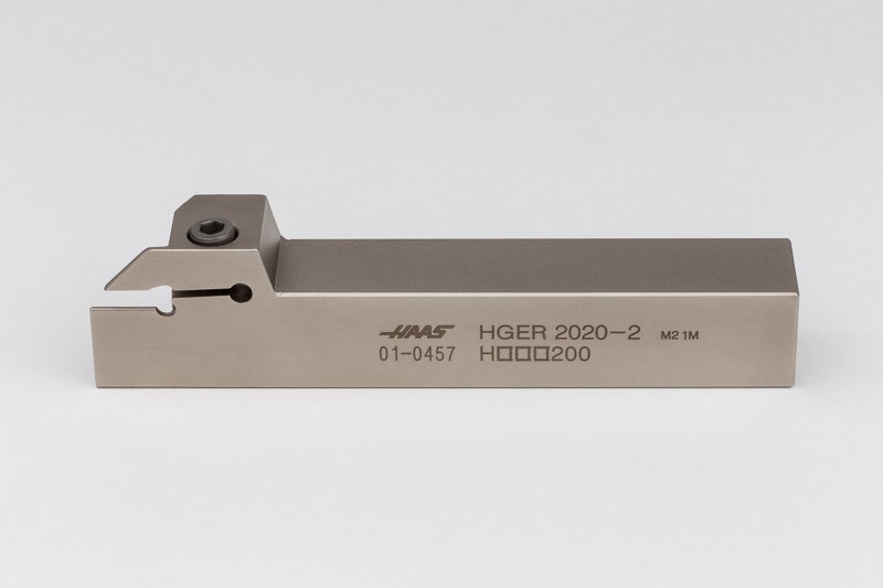

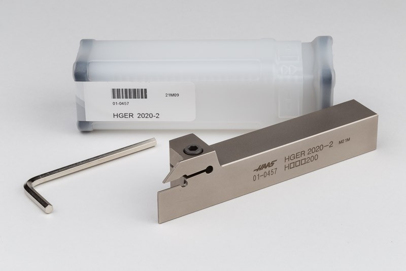

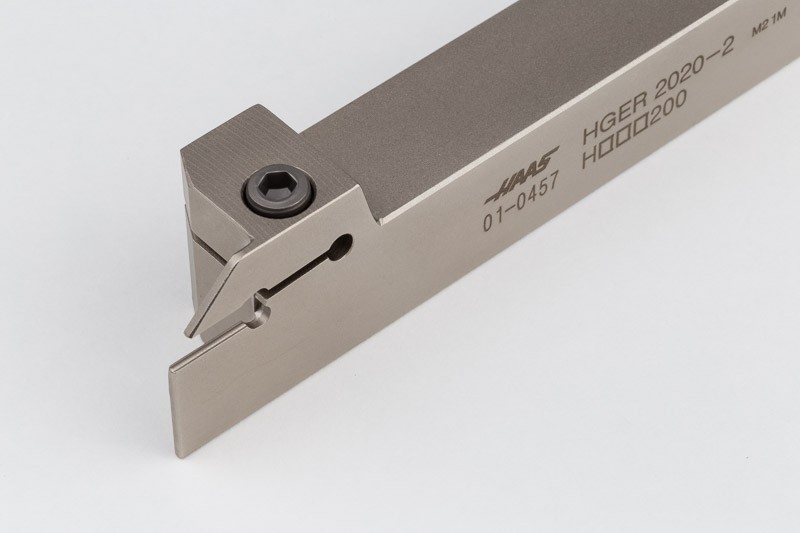

HGER2020-2, 20mm Square Steel Shank External (OD) Grooving Tool, Right-Hand, Insert Size 2
Part #: 01-0457
HGER 2020-2 OD GROOVING HOLDER
Price: 120.95 ( / unit)
Price: 1498.95 ( / unit)
Price: 446.95 ( / unit)
Price: 59.95 ( / unit)
Price: 269.95 ( / unit)
Price: 629.95 ( / unit)
84.97
1049.97
312.97
41.97
188.97
440.97
Tool Or Insert Tool
Tool Orientation External
Hand of Tool Right
Insert Style HGMN - Deep Groove Turn, HCMR - Part Off / Cut Off
[OAL] Overall Length 125.0 mm
[H1] Cutting Height 20.0 mm
[H] Shank Height 20.0 mm
[B] Shank Width 20.0 mm
[f] Dimension 20.25 mm
[CW] Cutting Width 0.079 in \ 2.0 mm
[T-MAX] Maximum Depth 14.0 mm
Through Tool Coolant No
Weight 0.8 lbs \ 0.4 kg
