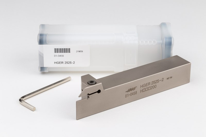

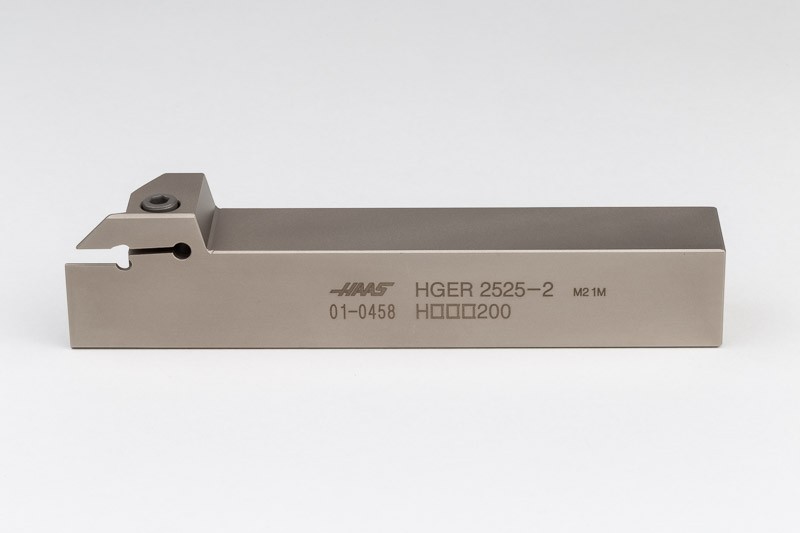

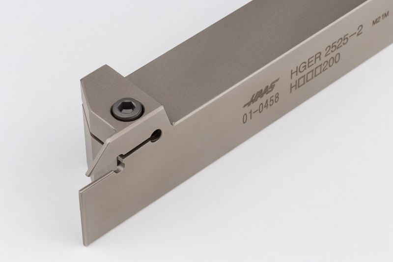

HGER2525-2, 25mm Square Steel Shank External (OD) Grooving Tool, Right-Hand, Insert Size 2
Part #: 01-0458
HGER 2525-2 OD GROOVING HOLDER
Price: 131.95 ( / unit)
Price: 1598.95 ( / unit)
Price: 475.95 ( / unit)
Price: 63.95 ( / unit)
Price: 287.95 ( / unit)
Price: 671.95 ( / unit)
92.97
1124.97
334.97
44.97
202.97
472.97
Tool Or Insert Tool
Tool Orientation External
Hand of Tool Right
Insert Style HCMR - Part Off / Cut Off, HGMN - Deep Groove Turn
[OAL] Overall Length 150.0 mm
[H1] Cutting Height 25.0 mm
[H] Shank Height 25.0 mm
[B] Shank Width 25.0 mm
[f] Dimension 25.25 mm
[CW] Cutting Width 0.079 in \ 2.0 mm
[T-MAX] Maximum Depth 14.0 mm
Through Tool Coolant No
Weight 1.5 lbs \ 0.7 kg
