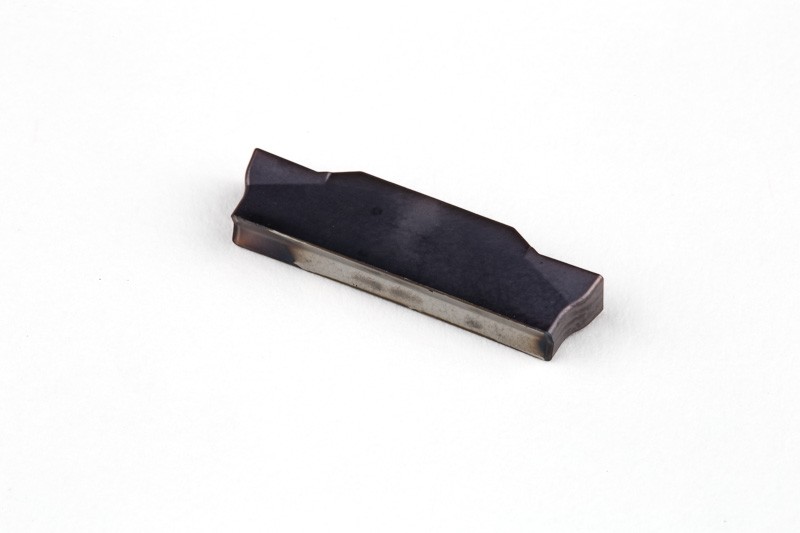

HTFD0303-HTG, 3mm Carbide Grooving Insert, Size 3, Grade HUU20P - Pack of 10
Part #: 02-1118
HTFD0303-HTG HUU20P
Price: 95.95 ( / unit)
Price: 2048.95 ( / unit)
Price: 609.95 ( / unit)
Price: 81.95 ( / unit)
Price: 368.95 ( / unit)
Price: 860.95 ( / unit)
81.97
1649.97
490.97
65.97
296.97
692.97
  • Speeds and Feeds
ISO Material Chart
Tool Or Insert Insert
Tool Orientation Internal, External
Insert Style HTG - Turn, Groove
Primary Workpiece Material K - Cast Iron, M - Stainless Steel, P - Steel
Grade HUU20P - Medium Finishing
Coating PVD-TiAlN
Configuration Standard

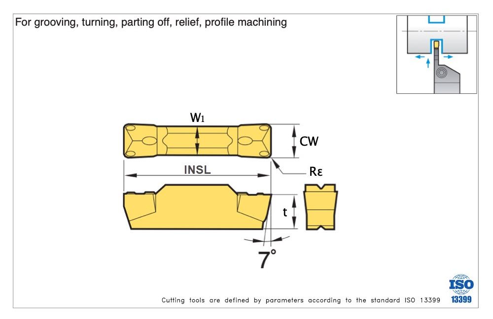

[INSL] Insert Length 0.807 in \ 20.5 mm
[t] Cutting Edge Height 0.189 in \ 4.8 mm
[W1] Insert Width 0.094 in \ 2.4 mm
[RE] Corner Radius 0.012 in \ 0.3 mm
[CW] Cutting Width 0.118 in \ 3.0 mm
Country of Origin USA
