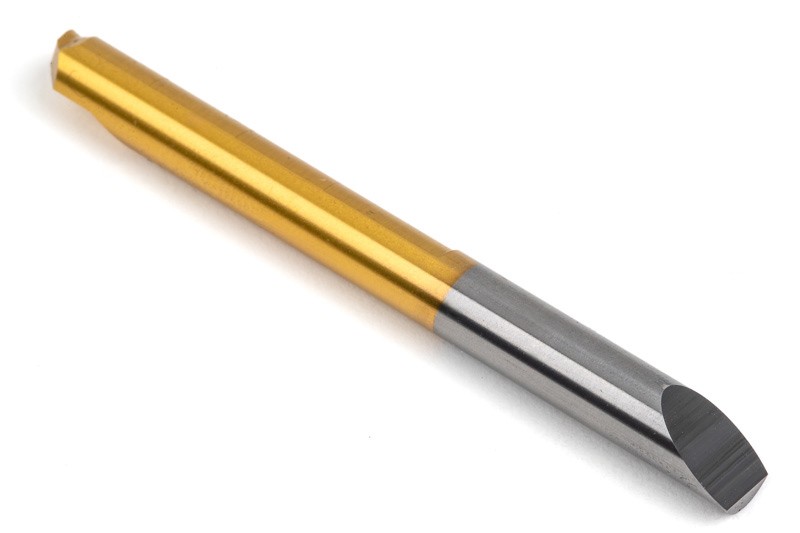

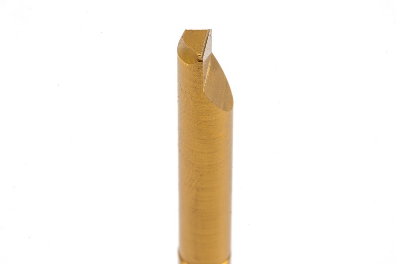

HMBCB-6, 6mm Ø Carbide Internal (ID) Micro Boring/Profiling (+CB) Tool, 6.2mm Min. Dia. x 35mm Head Length, Right-Hand
Part #: 03-3012
MICRO TURN, HMBCB-6R6.2-35-20 TIN

Type Tool
Toolpath Type ID Turn
Tool Orientation Internal
Hand of Tool Right
Insert Style HMBCB - Boring w/Chip Breaker
Secondary Workpiece Material M - Stainless Steel, S - High Temp Alloys
Material Carbide
Coating TiN
Connection Size 6
[ØD] Min. Machining Diameter 0.244 in \ 6.2 mm
[ØDMM] Shank Diameter 0.236 in \ 6.0 mm
[LH] Head Length 1.378 in \ 35.0 mm
[OAL] Overall Length 2.48 in \ 63.0 mm
[OHX] Maximum Overhang 1.59 in \ 40.5 mm
[RE] Corner Radius 0.008 in \ 0.2 mm
[T-MAX] Maximum Depth 0.02 in \ 0.5 mm
[S] Center to Insert Dimension 0.116 in \ 2.95 mm
