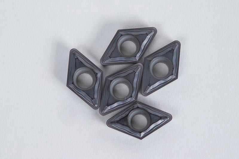

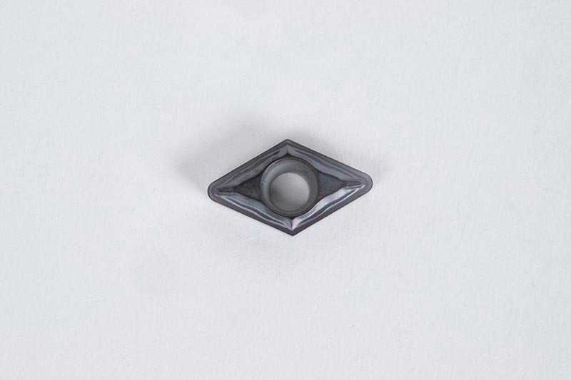

DCMT2152-HFP / DCMT070208-HFP, Carbide Turning Insert, 55° Rhombic, Grade HTS10 - Pack of 5
Part #: 02-0433
DCMT 2152-HFP HTS10
Price: 16.95 ( / unit)
Price: 298.95 ( / unit)
Price: 88.95 ( / unit)
Price: 11.95 ( / unit)
Price: 53.95 ( / unit)
Price: 125.95 ( / unit)
ISO Material Chart
Clamping Type S - Screw-On
Insert Style D Style - 55° Rhombic
Primary Workpiece Material M - Stainless Steel, S - High Temp Alloys
Secondary Workpiece Material P - Steel, K - Cast Iron
Grade HTS10 - Uninterrupted
Material Carbide
Chipbreaker HFP - Finishing Positive
[IC] Inscribed Circle Diameter 0.25 in \ 6.35 mm
[D1] Insert Hole Size 0.11 in \ 2.8 mm
[L10] Cutting Edge Length 0.305 in \ 7.75 mm
[S] Insert Thickness 0.094 in \ 2.38 mm
Country of Origin India
