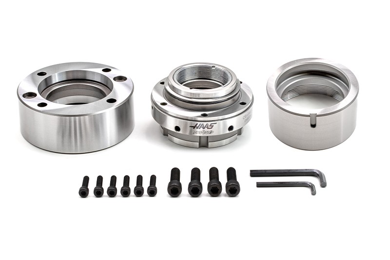

HQCB-65, Pull Back Collet Chuck for A2-6 Spindle Nose, M85x2 Drawbar Nut
Part #: 08-2076
HQCB-65 A2-6 M85X2.0
Price: 2399.95 ( / unit)
Price: 59998.95 ( / unit)
Price: 17855.95 ( / unit)
Price: 10799.95 ( / unit)
Price: 25199.95 ( / unit)
Haas Collet Chuck 65
____________________________
  • Pull back collet chuck
  • Compatible with older Haas DS-30Y lathesCollet changes in seconds (requires handheld collet changing tool)
  • High clamping accuracy and rigidity
  • Sealed design for long life and minimal maintenance
  • Uses rubber grip collets for better grip and larger gripping range
*VERIFY YOUR DRAWTUBE THREAD SIZE*
This collet chuck will only fit on Haas DS-30Y Lathes that feature an M85 thread. Please refer to the layout drawing of your machine to verify the drawtube thread on your machine to ensure an accurate fit.
Disclaimer: Spindle Reduction Sleeves / Liners length may need to be modified.
Technical Documents
  • Chuck and Spindle Nose Comparison Chart
  • Setup Manual
Type Collet Chuck
Collet Type Pull Back Collet Chuck
Machine Models DS-30Y
Collet Series HRG-65R, HRG-65RT
Spindle Nose A2-6
[ØD] Bore Diameter 2.6 in \ 66.0 mm
[ØBD] Body Diameter 5.7 in \ 145.0 mm
[ØA] Flange Diameter 6.5 in \ 165.0 mm
[ØB] Nose Diameter 4.72 in \ 120.0 mm
[ØF] Spindle Nose Diameter 4.19 in \ 106.38 mm
[C] Flange Length 2.4 in \ 61.0 mm
[E] Nose Length 0.93 in \ 23.5 mm
[OAL] Overall Length 4.73 in \ 111.0 mm
[G] Throat Depth 1.97 in \ 50.0 mm
Draw Nut Thread Size M85x2.0
Concentricity 0.0004 in \ 0.01 mm
Maximum Collet Capacity 2.65 in \ 65.0 mm
Minimum Collet Capacity 0.157 in \ 4.0 mm
Maximum RPM 5500
Maximum Clamping Force 23155.3 lbs \ 103.0 kN
Weight 27.8 lbs \ 12.6 kg
