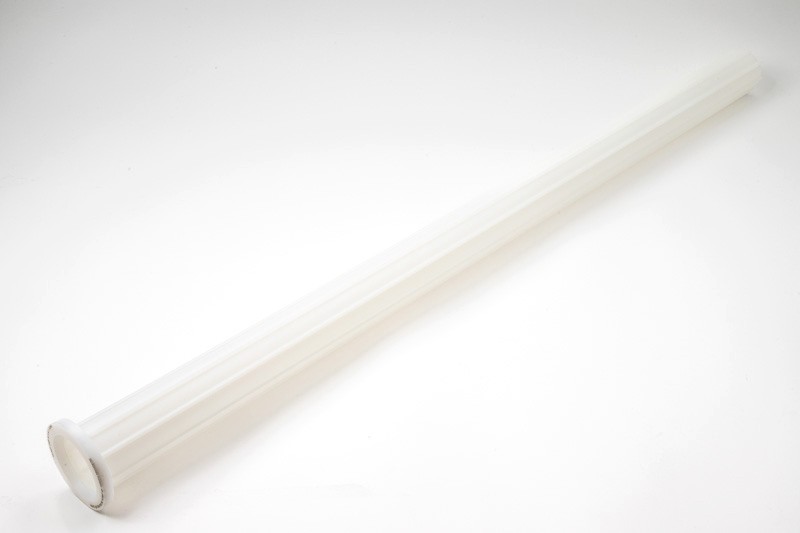

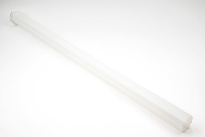

Haas 1.06m Extruded Spindle Liner, 55mm Bore Diameter x 64mm External Diameter, for Round Bar Stock
Part #: 05-0624
LINER 55 X 64 X 1220 MM​
Price: 314.95 ( / unit)
Haas spindle liners provide extra stability to bar stock during turning operations. Made from durable extruded high-density polyethylene, these spindle liners are an easy and inexpensive tool to utilize around the workshop. With a 55mm internal bore and a 64mm interference fit external diameter, these spindle liners are engineered to decrease vibration and maximize workflow with the use of the Haas Bar Feeder.
Type Liner
Machine Models ST-15Y, ST-15, ST-20Y, ST-20
Nominal Bore Diameter 55.0 mm
Nominal External Diameter 64.0 mm
[ØD] Bore Diameter 55.5 +0.25 / -0.00 mm
[ØED] External Diameter 65.2 ±0.254 mm
[ØA] Head Diameter 83.8 mm
[BL] Body Length 1066.8 mm
[OAL] Overall Length 1076.45 mm
Weight 1.4 lbs \ 0.6 kg
