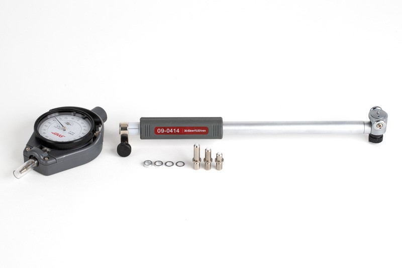

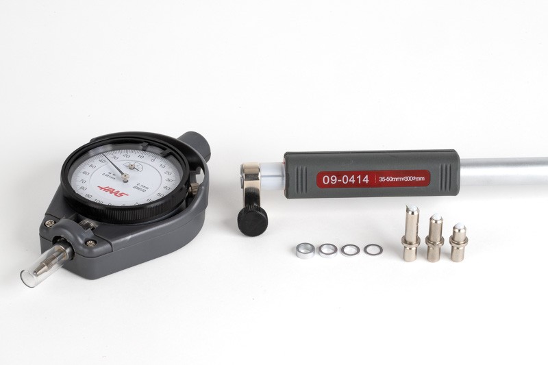

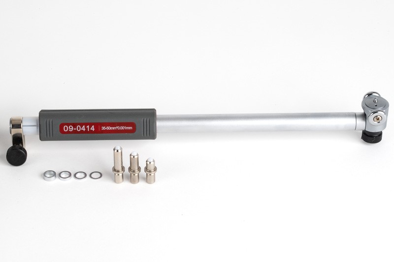

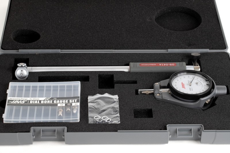

This Haas high precision dial bore gauge has a measuring range of 35.0 - 50.0 mm. It features a 0.001 mm dial graduation, a 150.0 mm depth reach, and a set of 4 ceramic anvils plus spacers to cover the entire measuring range. The continuous dial numbering is ideal for taking direct bore measurements.
  • Technical Documents
  • Operator's Manual
Type High Resolution Dial
Dial Reading 0-100
Dial Diameter 58.0 mm
Dial Type Continuous
Graduation 0.001 mm
Accuracy ± 0.007 mm
Range 35.0 - 50.0 mm
Range Per Revolution 0.2 mm
Depth Range 150.0 mm
Number of Anvils 4
Anvil Sizes 35mm, 40mm, 45mm, 50mm
Anvil Material Ceramic
Bearing Type Jeweled
Fulcrum Material GCr15
Hysteresis 0.002 mm
Repeatability 0.002 mm
Conformance Standard CNAS
Weight 2.6 lbs \ 1.2 kg
