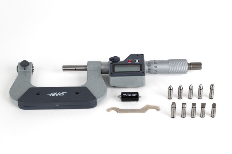

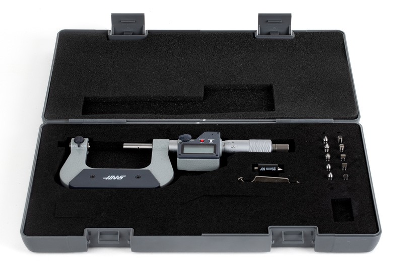

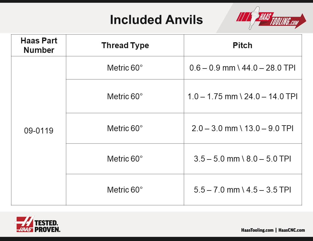

Screw thread micrometers are used to measure the thread pitch or threads per unit length of screw threads. This micrometer features a metric thimble graduation, digital screen, stainless steel anvils, and a stainless steel, non-rotating spindle. Included anvils can be found in chart below.

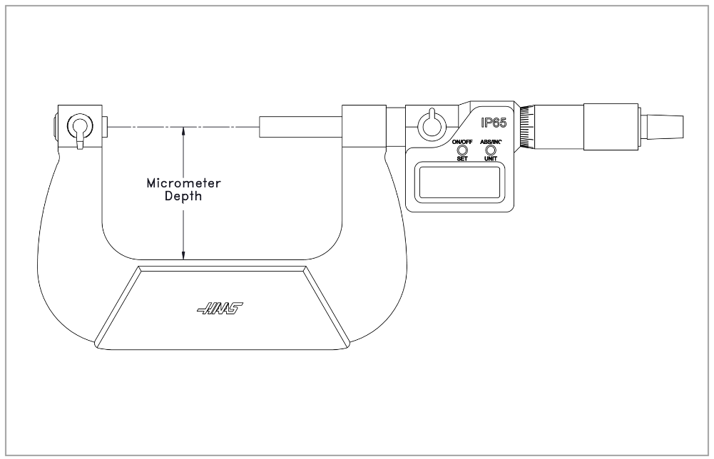

Micrometer Depth 38.0 mm
